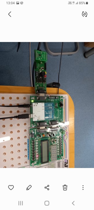

Thanks for reply. I have attached an image and since then connected the power as you suggested. I cannot get it to initiate. The program compiles but wont get passed the initialising of EBM004. I am sorry but my background is not in connection diagrams that you provided.

Re: Digital Temperature
There's no image attached to your post. Please attach an image of your hardware wiring and also attach your Flowcode program and we'll try to work out what the problem is.
I screenshot the image
- Screenshot_20211110-130409_Gallery.jpg (35.54 KiB) Viewed 35269 times
It looks like the EB090 has no power. See this from my earlier post:
If that doesn't fix it, please post your project file.
Just to add to Steve's post.
The D type connections do not supply power.
They supply signals and GND only.
If the only connections are via D connectors then it's what Steve has stated.
I did say that i had connected the power after I took the image and it still didn't work. I will set it up again and repost. I feel that we are getting somewhere so thanks. Will repost the new image soon. Thanks for your help.

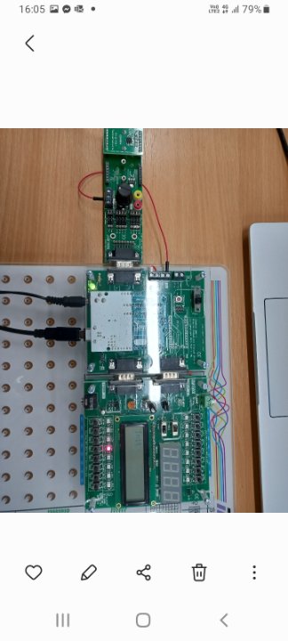

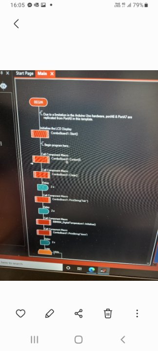

Here are the images. The program will not get passed initialising the EBM004
- Screenshot_20211110-160509_Gallery.jpg (35.1 KiB) Viewed 35248 times
- Screenshot_20211110-160516_Gallery.jpg (37.15 KiB) Viewed 35248 times
The connection looks ok, but I need to check your program. Please attach your program and we'll have a look - drag the file onto your post when you reply, or use the "add files" button on the "attachments" tab. Sorry, but a screenshot of your program is not sufficient.
There's a few things wrong, mainly to do with the connections you have specified for the sensor within your program. It has been a long time since I used these boards, so please bear with me. Also, I do not have access to these boards so hopefully the following is correct...
First off, your program has both the SDA and SDL lines of the connection to the sensor as PORTC.0. Obviously this won't work and you need to specify how the pins are actually connected on your hardware.
Looking at your hardware, the sensor is in "socket 2" of the EB090, which according to p5 of the pdf means it is connected to bits 3, 5, 6 and 7 of the D-type connector. This connector is connected to the E-blocks socket labelled "D8-13", which equates to PORTB of the AVR chip used by the Arduino board. Unfortunately, this port does not have all 8 bits available due to a limitation of the Arduino (the top 2 bits of the port are actually used for the onboard crystal). The upshot is you cannot connect the module like this.
Instead, you will need to connect the sensor to "socket 1" of the EB090. Then, S1-4 will connect to bits 2-5 of that port (page 5 of the pdf), which in turn equates to PORTB bits 2-5 of the AVR chip on the Arduino. Page 8 pf the pdf shows how this specifically relates to the temperature sensor. SCL is S4 and SDA is S3. S1 is INT (optional) and S2 is not used. Equating this to your program, SDA of your sensor needs to be set to PORTB.4 and SDL needs to be set to PORTB.5.
Hopefully making these changes (sensor into socket 1 and SDA/SCL to B4/B5) should allow the hardware to work.

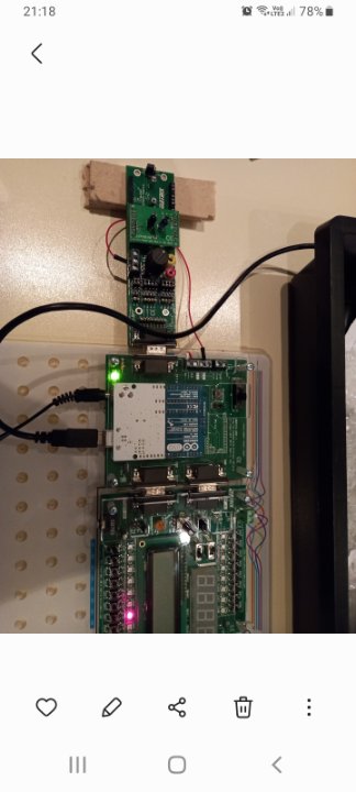

This is the hardware set up
- Screenshot_20211113-211858_Gallery.jpg (34.22 KiB) Viewed 35171 times
You have got the wrong target device slected.MartinSpeed wrote: ↑Sat Nov 13, 2021 10:17 pmTarget folder: C:\Users\hermi\DOWNLO~1
Source name: C:\Users\hermi\Downloads\Infrared Test1.fcfx
Title:
Description:
Device: PIC.16F.16F1937
Generated by: Flowcode v7.3.0.5
Your hardware has not got the PIC16F1937.
When you load an example flowchart, you must change the target device and configurations settings (if applicable) to match your actual hardware.

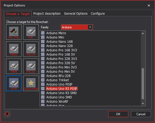

Anything to do with hardware, you use the Build menu.
To change the target device its Build, Project options, Choose a Target tab.
You will need to select AVR, then Arduino in the Family dropdown selection, then select the correct target: Within Build, Project options, General Options tab. you will need to select the correct programming port.
If you open the flowchart before connecting your hardware, you will need to select the Reload icon, which is situated next to save icon.
Note after changing the target device, you will more than likely need to change the pin connections of the components.

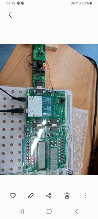

MartinSpeed
- Posts: 28
- Joined: Tue Nov 09, 2021 11:53 am
- Been thanked: 1 time
Here is the image of the component set up.
- Screenshot_20211115-091959_Gallery.jpg (41.2 KiB) Viewed 35133 times
MartinSpeed
- Posts: 28
I guess the pin set up on the infrared properties is not right but so many different combinations to try.
- Steve
- Posts: 3434
- Has thanked: 114 times
- Been thanked: 422 times
According to the datasheet, the infrared sensor provides an analogue output signal which means the output signal from the sensor (S4) needs to be connected to a suitable analogue input. Unfortunately, your hardware configuration has the sensor connected to PORTB of the micro, which has no analogue input capability. The use this (or any other) analogue sensor, your board would need to be connected to PORTC of the micro, which is the E-blocks connector labelled A0-A5 (the "A" means "analogue").
To do this and still use the EB083 comboboard, you would need to disconnect the boards and use cables to connect between the Arduino E-block and the other boards. EB090 would need to connect with the port labelled "A0-A5" and the EB083 connected to both the other ports (or possibly just one if you only needed the LCD).
