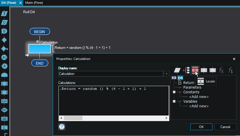

Hi, i am programming a DND dice roller for a college project but can't seem to get the random number generator part, used to simulate a dice roll, to work. could someone take a look at what i have done so far and try to get it to work.

That is because you are calling a user macro (D4) and expecting a return value.
Within the call user macro, you must specify
.Return
The
means it's a local variable.
Just select the Locals icon and drag
Return
or just type it in.
Your calculation should look like this:
Use Return.png (41.34 KiB) Viewed 5499 times

medelec35 wrote: ↑
Wed Nov 24, 2021 2:53 pm
.Return
The
Return
or just type it in.
Your calculation should look like this:Use Return.png
that seems to be working now thank you
