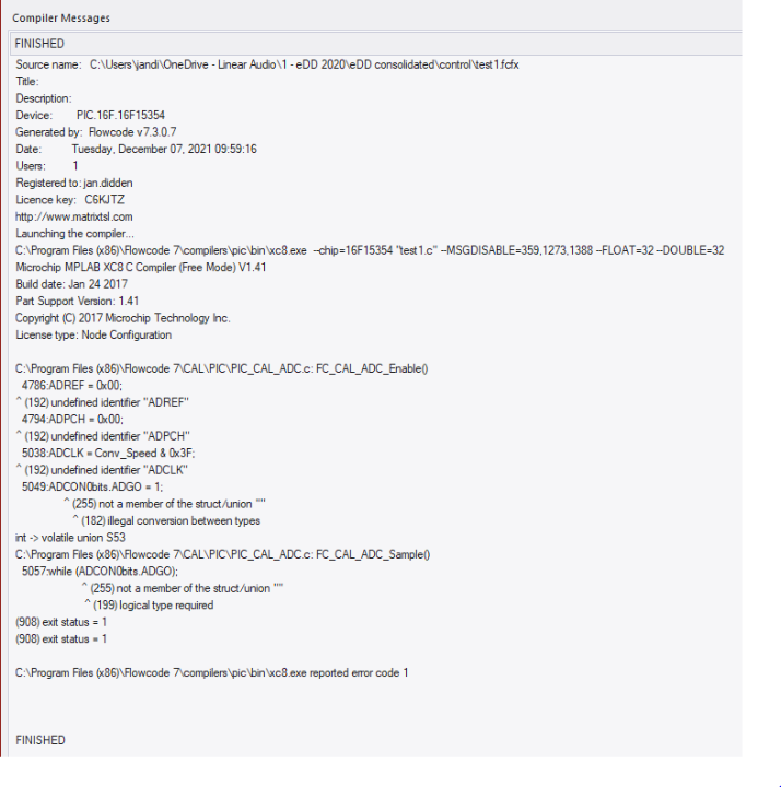

I am trying to build an app on the PIC16F15354 using the build-in ADC. I'm not doing any customization, just using the standard build in component.
But I get compile errors as shown in the attachment. Is there something I missed?

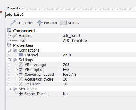

Edit: added ADC properties screen shot

Something I just thought of: do I have to explicitly set all the ADC related registers?
I assumed that the act off attaching the ADC base template top the project and setting the items in the Panel would be sufficient?
But since the error is 'unidentified identifier' it looks like the problem is in the PIC_CAL_ADC_ functions.

Hi Jan,
I have hopefully fixed the issue for you
The PIC_CAL_ADC.c replaces the file within the folder.
The 16F15354.fcdx replaces the file within the folder.

Martin, thank you very much for taking the time to review and fix this!
I had identified another similar PIC that did not have the issue (16F1788) but that one didn't have the AN inputs I used and I was facing the prospect to scrap a batch of boards that are underway from Far East. So you saved me money!
I will check this out and report if necessary. Understand the point on the AND and &&.

Martin, I just checked this out with the PIC16F15354 and it works flawlessly now.
