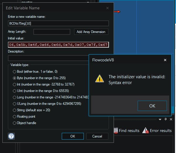

Using Flowcode 8 try to enter byte array and get "The initializer value is invalid" error.
Name of variable is BCDto7Seg[10]
Initializer type byte
Initializer values "0x3f,0x06,0x5b,0x4f,0x66,0x6d,0x7d,0x07,0x7f,0x67" typed into
initial value entry window.
Flowcode error 1.jpg (49.73 KiB) Viewed 12945 times

I beleive we added array initialisation in v9 but in v8 you have to do it the long way using a calculation icon in your program.
BCDto7Seg[0] = 0x06
BCDto7Seg[1] = 0x5b
etc
