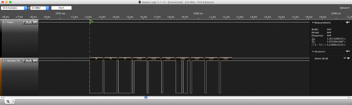

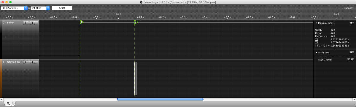

Post by Bachman »
Hi Abhi!
Try to add 250-300 ms delay before UART initialization. If you turn on the Nextion display, it's send out some data and it can make overflow condition in the PIC's receive side. Or, right after the UART initialization, try this C code:
U1CON2bits.RUNOVF=1;
U1 means UART1, modify it, if using other than UART1. I don't know, how Flowcode initializes UART module, maybe this help.

Post by Bachman »
Looks like, i've mixed up the things... :D Well, the Nextion display needs around 250 - 300 ms after power up to initialize itself. Just an idea, you can use this time. In the display, create a "welcome" screen (logo, picture etc.) as the startup screen (page 0). Initialize the controller, after initialization done, wait 1-2 seconds and start with screen 2 in the Nextion.
