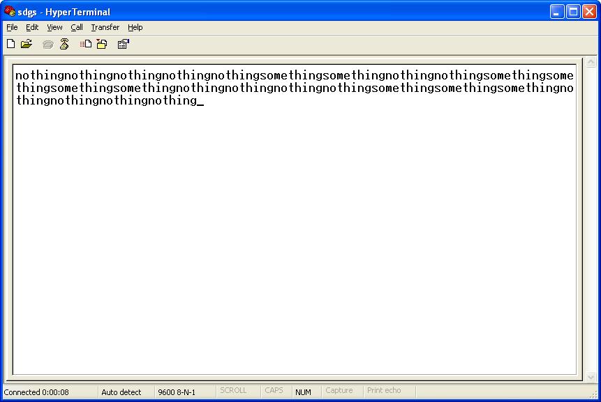

I mean, if i send something throught hyperterminal, the interrupt shoulbe jump.
I do this:
//ADDED BR - Call to Flowcode Macro "test"
FCM_test();
But no run.
Is it necesary enable the USBINT?
Yes: My program only do the interrupt, not run the main program.
No: My program is only doing the main program, and don´t jump the interrupt.
Thanks for everything.

Re: ECIO and use of USB in Flowcode
I just tried your program as is and its working great for me. Did you edit the usb_cdc_class.c function like I mentioned above to include the call to FCM_test();
You do not need to enable the USBINT and should never need to use it with the USB components.
Also I noticed that your clock speed in the project options is set to 16MHz. USB runs at 48MHz (12MIPs) so your delays will currently be much shorter then they should be. Changing the clock speed to 48000000 should allow the delays to run at the correct speed.
I've also had a quick look at your config settings and my only suggestion would be to change the USB voltage regulator setting so it is enabled.

Yes, you're right.
This run ok, but two questions.
