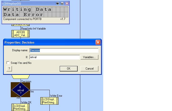

[img]C:\Documents%20and%20Settings\Andreas%20Achilleos\My%20Documents\My%20Pictures\mmc.jpg[/img]
hello Ben,
I have some questions regarding the data logger. As it shows in the pic taken from the flowcode program, you can see that in the "if statements" it writes only "retval", should not be there any ecual sign or less/more sign?
Also when I run the program at the end after the delay ends, it shows on the LCD> writting data /data error>that means that it was trying to write the csv values but the file was allready there?
When it reads from the ADC channel it takes only one value or 128? Saying that, the log file will have 128 c,s values?

Re: Data Logging with a MMC/SD card
Hello Achillis
Writing just the variable name in a decision icon will have the functionality of returning a no if the value is 0 or passing a yes if any other value.
Yes the program will also error if the file already exists. You could either check for the file and delete at the start of your program or append the file if it already exists. For the examples to work correctly you must delete the file by hand using a computer.
Each ADC channel read only creates on piece of information.
You can use the slower method to write single pieces of data if you do not want to fill up the 512 byte buffer before sending off the data to the card.
What about making a file for each RFID card that is scanned. If the file already exists then a time and date is appended to the card using the slower method of appending data. If the file doesnt already exist then a warning goes off etc. Also might want to append check in and check out if you have seperate RFID readers for the entry and exit. Or use a single file and simply append every RFID action to the card as it happens. The Slow method of appending data will be more useful to you here and is only Slow in terms of shifting large amounts of data (eg KBs or MBs, its actually quite fast still).

Forgot something to say regarding the "data_logger_simple_slow.fcf"
When I run it with simulation speed: 10 then after when the simulation completes the LCD shows: "writting data
data written"
If I run the simulation "as fast as possible" then it will display: "writting data
data error"
After some 50 "runs" the error also is displayed in simulation speed 10!!!!!!
data written"
At the moment the Beta components and the FAT component (if you have the non custom code version) do not simulate. Any results you get while simulating are random at best.
