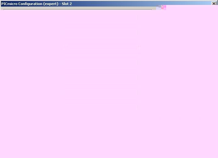

Please can you click on the Chip -> Configuration menu and then click switch to expert mode.
In here you will have to use the following settings to get your program onto the chip correctly.
- Config Screen.JPG (67.35 KiB) Viewed 2247 times
