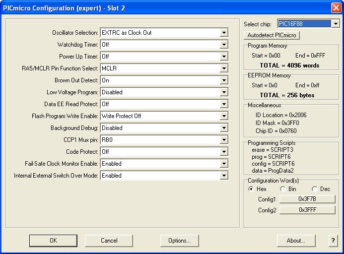

I have a new Multiprogrammer, LED board and flowcode.
I have installed all the software as recommended and have successfully written a simple flowcode program, which runs fine in simulation.
I have connected the multiprogrammer - complete with 16F88 as delivered - to a 13.5V DC supply, have set the relevant jumpers to USB (not ICD2) and to PSU (not USB)
When I try to compile to chip from flowcode, I get the following errors :
'Could not ID the onboard chip ...... ' to which I reply OK. and
'PIC Micro has not been erased, OK to continue' to which I also reply OK.
The final message in the programming window is ..
Programming failed: <config1> & <config2>
That took 47.609 seconds
Erasing the PICmicro
Programming failed:
Any thoughts anyone?
Attached is a copy of the advanced confic screen for the chip.

Re: Cannot get going at all
Hello
Please can you confirm that there is only one chip plugged into the Multiprogrammer board and that it is the correct way round etc, This has been the reason for similar problems in the past. The only other chip that should be present on the board is the U1 USB chip.
Do the green and orange LEDs light up?
I had exactly the same error message when I first tried to id the 16F88. I think I solved it by moving the switch from XTAL to RC. Perhaps the 16F88 doesn't support XTAL mode? Anyway, I also noticed that the red LEDs were running a pattern as if the chip was already running a program. I guess that was normal behaviour; a test program?
Anyway, hope this helps.
