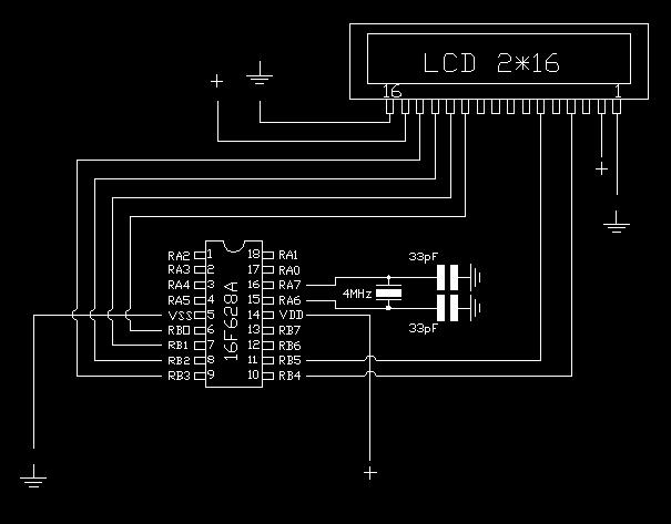

Hello everyone.
John here, has been working evening for a week now.
Working days again.
I download the new file.
But I can not it work, I have tried to create LED Flasher for 16F628A.
Can not make it work.
I have bought a 16F628A just to be sure it is ok.
I checked my connections and they are ok.
I will not give up to get the LCD display to work.
But I suspect that few 16F628A may be something with the configuration.
And at I program it with icsp pickit2.
Pickit2 says program to chip ok.
I have crystal at 4MHz to 16f628A.
Can anybody tell how configuration should be for 16F628A with crystal.
I know that it is set to XTAL in PPV.
Is there anything I have missed.
I am stupid or what

I read this with pickit2.
I found nothing that I have done wrong.
Maybe we should take on everything from the beginning.
LED Flasher operates chip 16F690 but not on 16F628A.
Of course, I have 2 equal program a 16F690
and another for 16F628A.
Can I make a mistake with the link with the crystal on 16F628A RA6, RA7.
How would you have done to achieve this I am trying to do.
And when I download to chip all goes well.
Program success.
Code 0.
Grateful for any assistance
Foppa
Program success.
Code 0.
Foppa

Re: lcd how to do
This does not work either.
I give up.
What I can imagine that is proplemet is icsp
for 16F628A.
or will try to have text on the LCD with 16F690.
foppa
I give up.
for 16F628A.
foppa

Re: lcd how to do
If PICkit says the program has gone into the chip ok, then it has. The problem will be either electrical (problems with power or oscillator, or the chip itself) or a problem with the configuration data (LVP, oscillator, MCLR).
