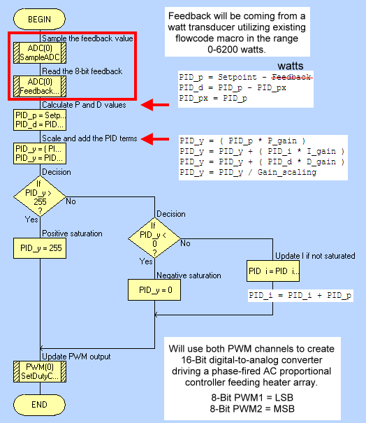

Below is an image of the PID Macro given in the Matrix example program + some notes on what I wish to do.

Firstly you will need a scaling factor to convert your input control signal into a 16-bit signal. This then creates the correct amount of error to plug into the equasions.
16-bit = 0:65535
65536 possible values / 6200 = 10.57
Reducing this to 10 will simplify the calculations and give us a range of 0:62000 on the PWM output.
So the control signal will be multiplied by a factor of 10 to give the range of control with the 16-bit PWM output.
You will also need a way of converting the error input into a number equivalent to the output PWM. This will probably require calibration to get this correct. Essentially you want a value of 62000 or 6200 x 10 or 620 x 100 etc to equal your output power of 6200 Watts. A analogue voltage of 3.027V would give you a value of 620 when using the 10-bit internal ADCs ( (5V / 1024) x 620 ) . Therefore if you can produce an analogue voltage that is linear with the output Wattage and that gives approx 3.027V when the Wattage is at 6200W then you have the error signal sorted.
Alternativly you can manipulate the maths if the error voltage or output Wattage is not that controllable.
It is then quite easy to fit the PID equasion in using the current control signal, the current error and one or two orders of previous errors.
If you need the full PID equasion then I can dig it out for you but I think it is included with the original PID example.

Opps! just found a potential problem with your suggestions. That is representing various signals in 16-Bit format. Flowcode only has signed integers, which means that anything over 32767 will cause an overflow (or is that considered underflow?), and be considered a negative number. So I think I'd be better off to leave the following in an unscaled format for the equations, in order to keep everything at the correct polarity so-to-speak:
Wattage feedback from the transducer (yes it is linear: 0-2.5V = 0-6250): 0-6200
I am not allowing the full range... leaving a 50 watt buffer zone. The wattage transducer is being read from an external 16-Bit ADC and the reading is stored as a flowcode integer called watts (As you can see, I am only using 13-Bits of the ADC's full resolution range).
Setpoint is entered from a keypad: 0-6200
Stored as a flowcode integer called setpoint
So PID_p = setpoint - watts will yield a number from 0 to 6200 which is easily represented within a signed 16-Bit integer, and without it overflowing.
Seems like scaling of the error will have to be done at the end where it will need to be translated into its LSB and MSB aspects to drive the 2 8-Bit PWM's. Unlike the ADC used to derive the wattage feedback signal, I am using the full 16-Bit resolution to span the control voltage driving the phase-fired proportional control module (Crydom). Although the there is a bit of play before turn-on and topping out.

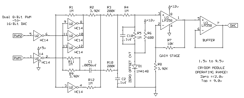

Below I have attached a schematic of my Dual PWM 16-Bit DAC.
