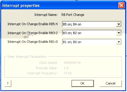

I need to do two things.
How do I set up Flowcode to:
1) Call a macro on GP1 changing from 0 to 1, and call a different macro with GP1 changing form 1 to 0.
Macro is not called if any other GP bit changes. I have a look at INT on port change, and got a bit confused with:
INT Port Change.JPG (23.49 KiB) Viewed 12017 times

Re: 12F675 Mains Zero Crossing Detection Using Single Resistor.
Hello
1) Use the same macro. Simply make a desicion depending on whether the pine starts off as a 1 or a 0 and act accordingly.

1 “Use the same macro. Simply make a decision depending on whether the pine starts off as a 1 or a 0 and act accordingly”
As I stated I was confused with port change interrupt. Are you saying use the GP2 INT, but set both rising, and falling edge to call same macro, or are you saying use Port change interrupt?
If latter, how is it set for just one pin? When it looks like you need to set for RB1 , RB3 an RB5.

1) If you use the port change interrupt then the interrupt will occur every time the data is changed on the pin eg so you wont have to mess about changing the polarity of the INT interrupt. The port change interrupt will then call a single macro when the pin changes state. At the start of your interrupt if you need to do different things depending on the current state then you can read the pin and process as required. Look at the properties for the port change interrupt and you should see that you can enable and disable every pin using the drop down options.

Ben. Thanks for all your help. I re-looked at port change as you suggested, and I can see now how easy it is :oops: . I was just have a off day when I first tried to work it out. That's my excuse and I'm sticking to it :P
