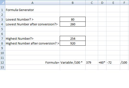

I have developed a very basic formula generator for use in Flowcode.
It could be useful if you have a variable with a number range,and you want the result to be a different number range.

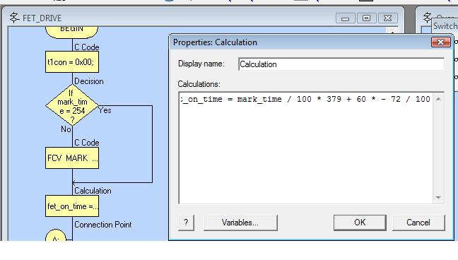

E.e you have a lowest number of 80 and highest number of 254 and you want the result to be a number between 260 and 920
If you enter in attached excel sheet in correct boxes: 80, 254 , 260 and 290
A formula will be automatically shown, what is required to put in the calculation box of Flowcode
In the above example formula shown is: Variable /100 * 379 + 60 * -72 /100
so in my case if mark_time = 80 then fet_on_time after calculation will be 260
if mark_time = 254 then fet_on_time after calculation will be 920
mark_time = 150 then fet_on_time after calculation will be 525 etc.
excel ss.jpg (27.48 KiB) Viewed 6541 times
Just one suggestion, if the formula generates a series of hashes #######, just unlock worksheet, make columns C and E wider then re-protect worksheet.

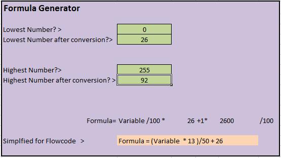

Thanks for the input guys.
Yes I realised about integer maths since Flowcode will not allow decimals to be entered.
I have changed Formula Generator slightly to enable formula to be reduced easier.
E.g. I wanted a time delay varying form 2.6 ms to 9.2 ms.
So when I entered values required, I entered 26 and 92 for lower and upper limits.
which had to correspond with 0 and 255 respectively
Formula Generator displayed following formula :Variable/100*26+1*2600/100
Reducing = (Variable * 13/50)+26
To test by substitution:
Variable = 0:
a=0*13/50+26=26
Variable = 255:
a=255*13/50+26=92.3 = int 92 which was good enough for my application
Then I use C Code delay_100us(FCV_VARIABLE);
You can also use formula Generator if you want PWM with e.g. a duty of 20 - 50% should correspond with ADC giving i/p 0 to 5V = 0x0 to 0x255 etc.
Re brackets. Does calculations within Flowcode and PIC's follow BODMAS?
Update!
I have updated Formula Generator to auto reduce fractions, so you don't have to!
It may not be perfect (just look at the colours :lol: ) or fool proof but I'm sure it will save time,
since you should be able to enter displayed formula directly in to Flowcode calculation box.
Formula Generator.jpg (21.54 KiB) Viewed 6441 times
