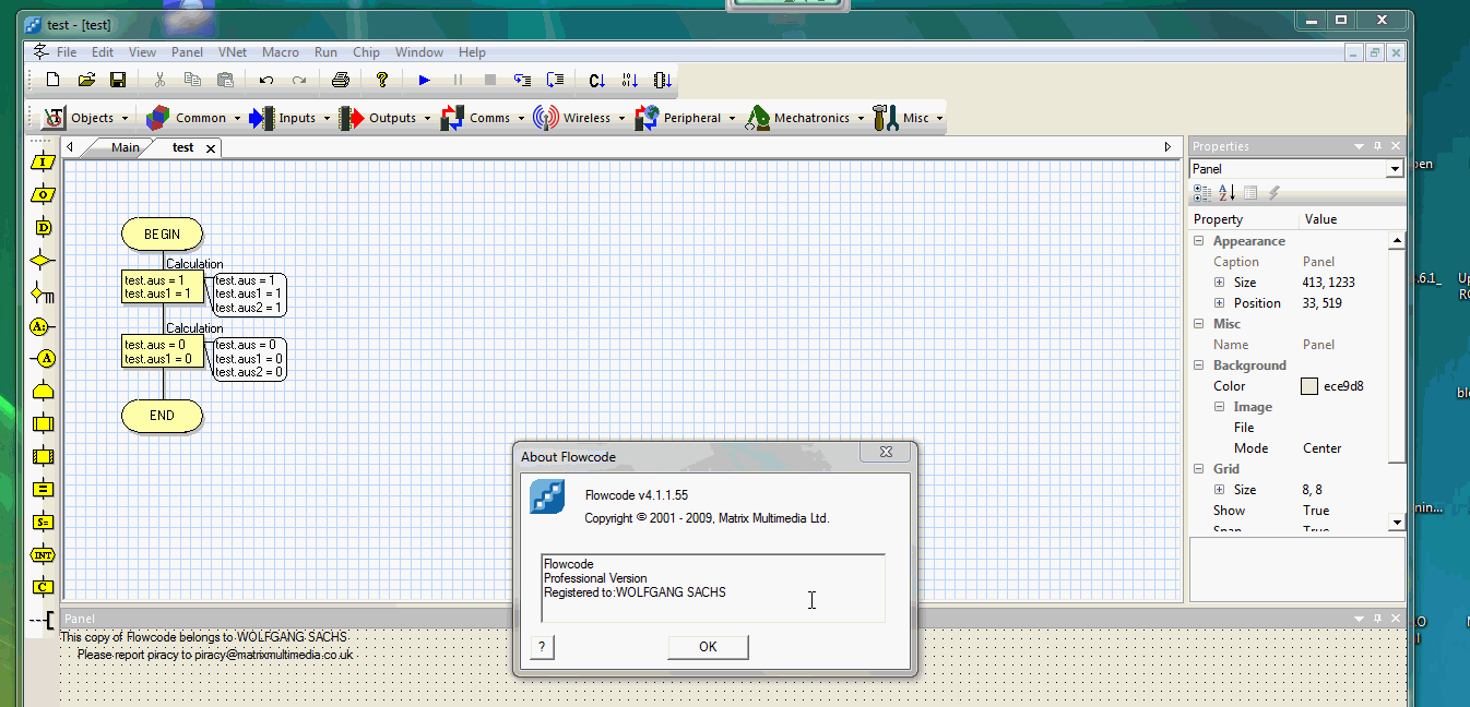

Hello Benj
Please have a look into the sample for test.aus,test.aus1,test.aus2 and simulate ,i have the new version .
Regards Wolfgang

Hello Wolfgang
Yes ok this is the latest version. I see that the global variables in the watch window remain correctly but local variables are removed from the window.
Also I see what you mean now about the toolbar popping back to the top menu. This only happens if Flowcode is closed or a new instance of Flowcode is created.
