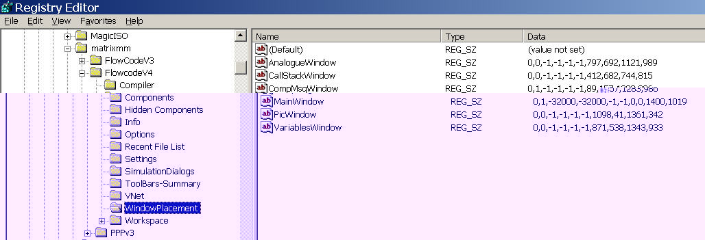

This afternoon ,after a long session, I encountered the same problem that was already mentioned in this forum: I lost my panel.
The vertical height of the panel is reduced to zero. I tried everything I can imagin. but until now I didn't found a way to retrieve it.
I worked several days on this project without a problem and I have no clue what triggered the disappearance. I didn't touched the panel properies since the start.
I did noticed however that after reopening the session, the panel randomly changed its size frequently.
I also checked the registry to find out if I could change the panelheight manualy, but I find every other window sizes, except the one from the panel.
Can you explain me how to reset the panel height, because in the property window it is not changable and I prefer not to re-enter the complete program.

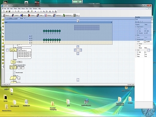

Re: Lost panel
Hello
For these problem i get the answer...... show screenshot
Steve wrote there is a patch ready,but:
We've fixed this behaviour in the panel now, but we will not release this just yet
Regards Wolfgang
Regards Wolfgang

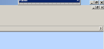

Re: Lost panel
Hi Steve,
Mmmmm,
I don't think so.
If you grab the titelbar of the panel and move it as far as possible to the top, you get this: If you now grab the lower edge of the panel and move it up as far as possible, there is a moment that you can't go further upwards.Like this: The same is valid if you shift the panel to the right.
It is impossible to shift the panel to zero. I really think it is a bug.
But if you can find out where I can restore the height ( if necessary in the registry) I can live with it for the moment.
Best regards,
Eric

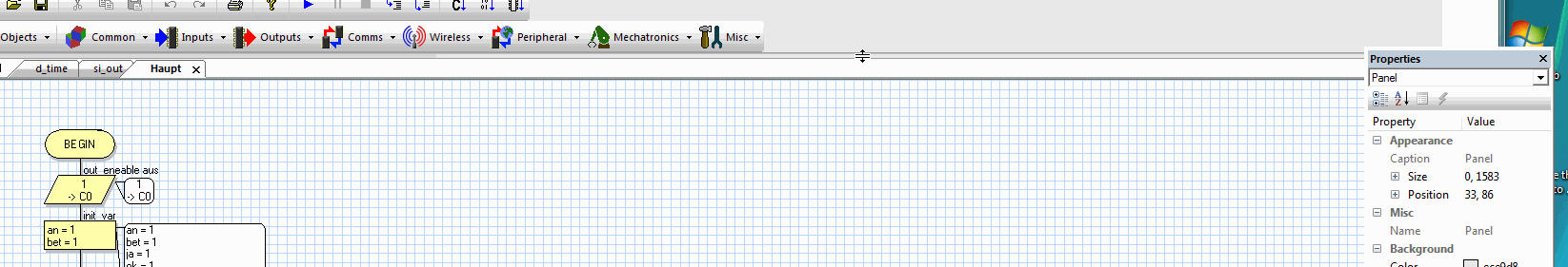

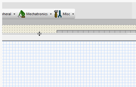

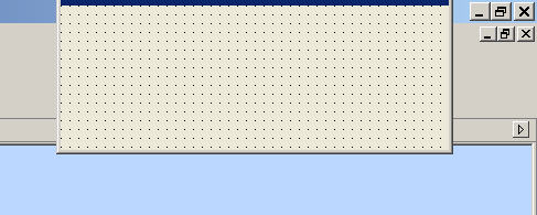

Re: Lost panel
Hello Eric
I can reproduce now:
show the screenshot`s.
I can open the panel if i go with the mouse over the line for " = " > left mouse-button down > move down > panel open.
Regards Wolfgang
Regards Wolfgang

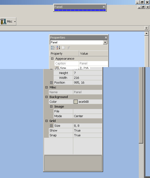

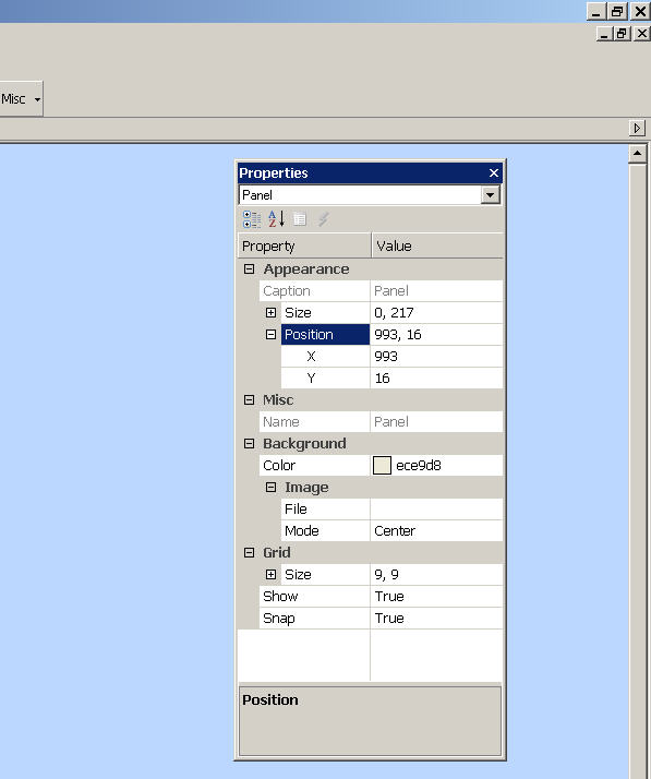

Re: Lost panel
Nice, Wolfgang.
But I cannot.
Your panel is docked. I always make make panel floating so that I can shift it aside and have more workspace.
There is no way to grab my panel and expand it back.
It should be here:
And this is were it is (compare the coordinates):
Steve, no way to change the size value?
Rgds,
Eric
But I cannot.
It should be here:
Rgds,
Eric
Re: Lost panel
I checked every spot on the screen: nothing to grab.
I think i have the same problem as Wolfgang (height returned to 0 ), but because his panel was docked and not floating, he still could find a point to grab.
Mine was floating, so I don't know where to grab.
