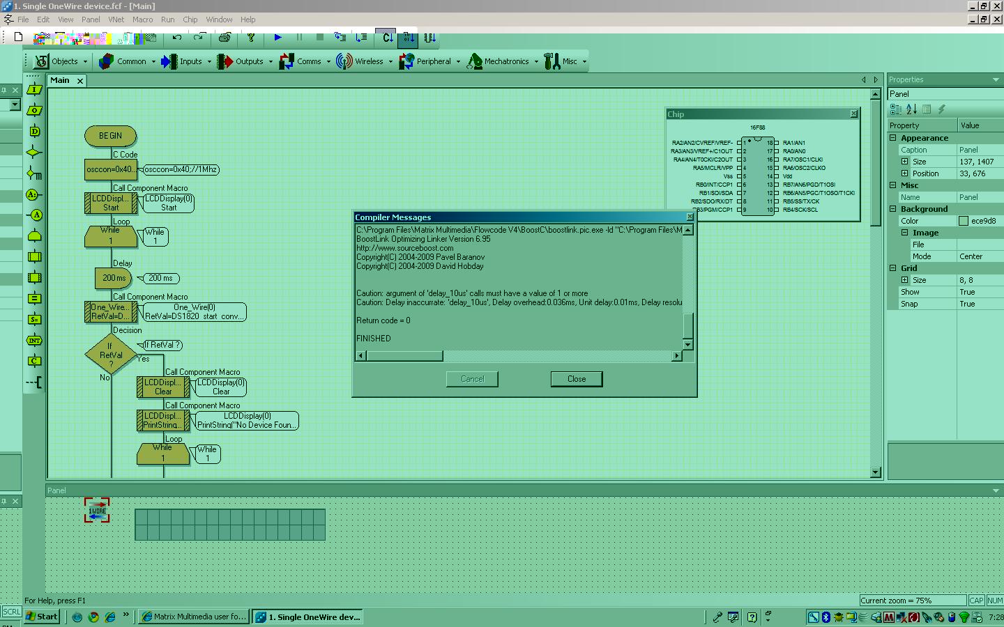

Additionally Im getting a delay problem with your code when I try to build the download file
Please see attachment

Re: One Wire Example - Failure on linking
Hello
The message you showed in your screen shot is meerly saying that at your clock speed of 1MHz the closest the 10us delay can come is 36us. This should be fine and shouldn't cause any problems.

Eric,
Thanks - I will give the program a try
Best Regards,
George

Please remember: the program will not simulate because there is no one-wire simulation in Flowcode.
You need at least 1 real sensor DS18S20 or DS18B20 connected to port A0.
You will see something like this on real hardware : 8 sensors ( 5 DS18S20 and 3 DS18B20 ) and display_res of 3 digits :
gggwww
Posts: 54
Joined: Wed Sep 09, 2009 12:50 am
Has thanked: 1 time
Post by gggwww »
Eric,
Can I run your program on a 16F877a? If possible, what crystal frequency - any special considerations? thanks for the help!
George
Eric
Posts: 99
Joined: Tue Nov 06, 2007 11:04 pm
Been thanked: 1 time
Post by Eric »
George,
I haven't tested it on PIC16F877 but I see no reason why not.
I use a crystal of 8 Mhz
Regards,
Eric
