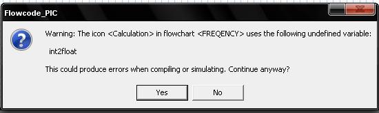

This will not work...attached is a pic of what its telling me and when I continue anyway it goes in an endless loop that wont allow me to stop simulation..have to cntrl alt delete and cancel the flowcode process to break it

Re: adc controlled PWM output???
Hello
OK theres a fix coming for the problem you are having. For now I will have to do this another way. Please bear with me.
Hello
Ok this version of the program will not simulate though it should run fine on your hardware. Make sure you define a chip configuration before trying on hardware.
The program I sent before will simulate but it requires some of the fixes that are included in V4.2 of Flowcode, this is why you could not run this correctly before.
