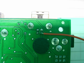

Re: EB006 Rev7 USB power needed to run program?
Yes I have been able to replicate the problem. The 18F4455 device on the EB006 is connected through to most of the pins of the target microcontroller to allow for a potential future scope application. However when the board is disconnected from the USB the 18F4455 is no longer powered. In some cases this allows a small amount of current to go through the 18F4455 input pins which can lead to problems like you are currently experiencing.
If you need to remove this problem from your board then you can connect a wire from the USB to the internal 5V supply which will mean that the USB chip is always powered. If you wish to do this then use a wire from the +V screw terminal on the EB006 and solder the other end of this to the USB pin shown in the picture below. I have tested this setup and your program is now working correctly with the USB disconnected.
Before plugging the USB cable back in I would disconnect the wire from the +V terminal to allow you to reprogram the device correctly and so the 5V regulator is not overstressed.
Hello Ben,
I thought you may be needing this mod to allow you to embed the EB006 into an application and leave it there.
However as students are going to be using the boards I would not recommend the mod I suggested, you are also correct the board would no longer be covered under our warranty.
Its a tricky one because the 18F4455 is connected directly to the USB power and permanently shorting the internal 5V with the USB power means that programming will not work correctly.
Can you simply ensure that the USB cables are always connected when working with the students or is this not a possibility?
Another alternative for a permanent mod is to simply remove resistors R31, R34 and R35 from the board but this will break any future scope functionality on pins RC0, RC3 or RC4. As long as you do not damage the PCBs when doing this im sure we can still allow the boards to be under the normal warranty. Eg if you ever have to return them to us then please include a cover note stating the mods that have been made. [EDIT- NO, see below!]
This is the first time I have seen this setup on the EB006 causing a problem so It looks like it is only the EB023 that will cause any problems with the USB cable disconnected.
