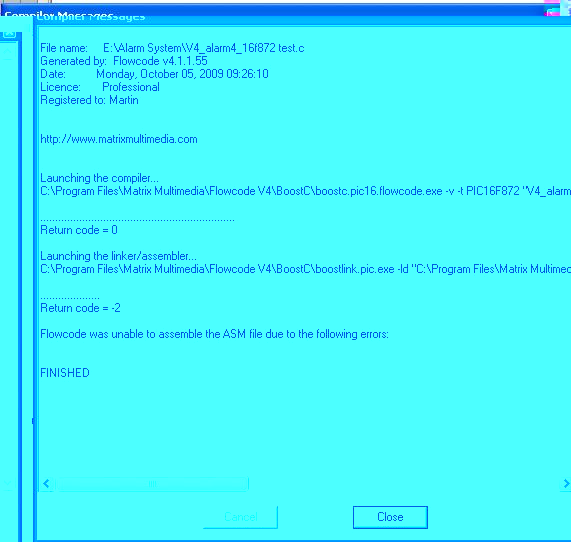

When I compile to hex there is unable to compile and –2 warning.
On three different PC’s the reason for error was not shown.
Two of the PC’s has Vista, and one has XP windows.

There is a known (and annoying) bug in the current v4 release that means if the amount of text emitted by the compiler is too large, the text is not transferred to the "compiler messages" screen. This has been fixed, but the fix is not publically available yet.
Here is the error list from your program:

As you can see, there seems to be a real problem fitting all of the variables into RAM. If you use an alternative PICmicro (e.g. 16F876A), then the file compiles fine.
But there is another potential error - your interrupt routine calls LCD macros. This is a real no-no. I think there are quite a few discussions on the forum about interrupts (there is also an article I think). Basically, the golden rule about interrupts is to keep them as brief as possible (i.e. no delay routines or macro calls) and do any major processing in the main "thread" of your program.

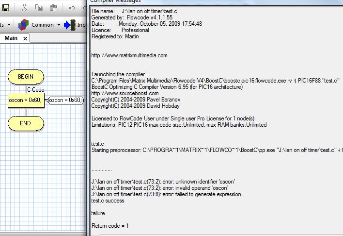

Ihave just tried to compile the most basic flowchart.
That also does not display errors. Surly it can't be due to low on memory since only problem is deliberately misspelled osccon in a C box.
I thought that bug was solved?
When I did same test on previous version of flowcde some time ago, the misspelled word and line was displayed OK.
Would you mind sending a fix for that please. It would not be practical emilaing a flowchart duing development, when it does not compile.

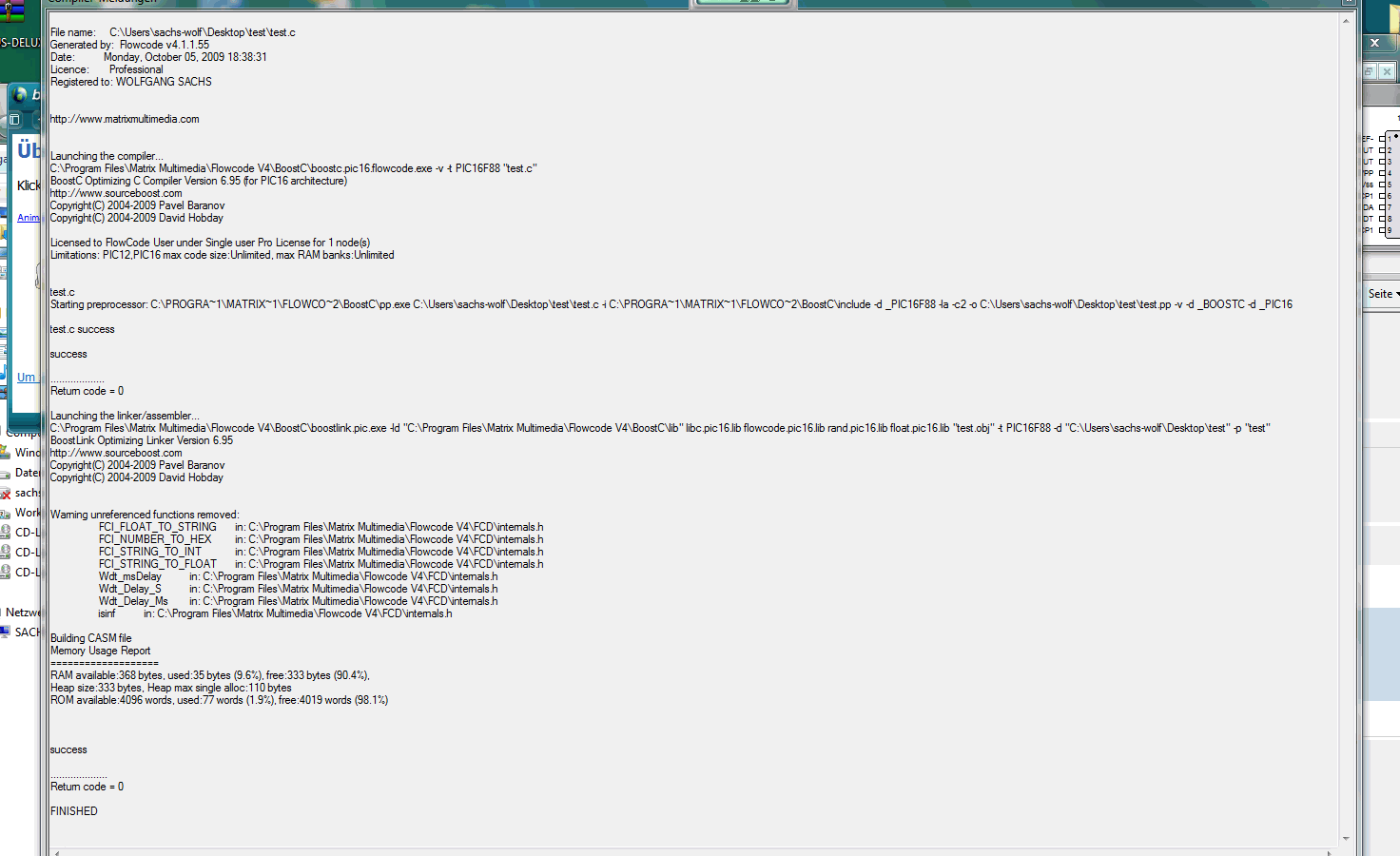

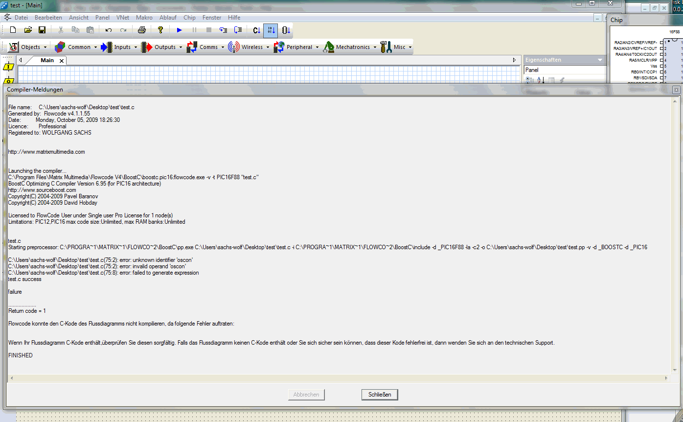

Hello medelec35
in my compiling window i show >> schreenshot
so i have a look in the datasheet ;there is not a oscon reg but a osccon!
Flowcode v4... give my many question`s... e.g why jou dont have the same compiling-window with the thame v4.1 ?
so i wait for v4.2
Regards Wolfgang

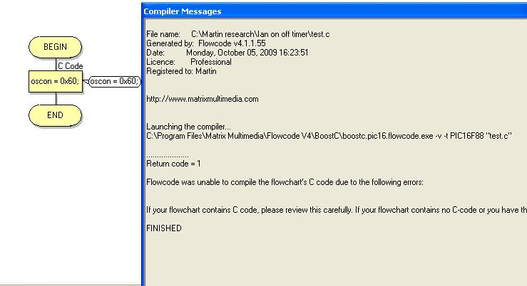

saschech@gmx.de, The osccon in the flowcode was deliberate spelt wrong to demonstrate that flowcode was not displaying any errors, on the PC I was using
medelec35 wrote: since only problem is deliberately misspelled osccon in a C box.
However on a different PC, (the one I originally tested a similar misspelled word on) errors are displayed OK (well 98% of the time).
So there still is a bug there!
not compiling 3.jpg (63.96 KiB) Viewed 8064 times

saschech@gmx.de wrote:why jou dont have the same compiling-window with the thame v4.1 ?
If you are referring to background shades, The darker shade is on a PC with windows XP, and the white background is on a PC with windows Vista.
If that's not what you was referring to, can you rephrase question please.
