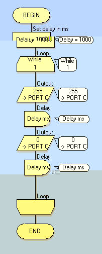

Consider this testprogram:
I need a delay with a value depending on certain conditions.
So I attributed the variable "delay" with the value 1000 ms.
In the delay icon I use this variable to generate my delay.
The problem I have is that if I want a delay of eg 1000 ms, the real delay on hardware seems always to be a delay of 250 ms.
Every value greater than 250 seems to generate the same delay of 250 ms.
If I don't use the variable " delay" but enter 1000 directly in the delay icon, the delay is ok.
Are there other ways to generate a delay using a variable?

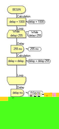

Eric. Your best way to achieve high number delay is the way Ben suggested in a different post:
Benj wrote:When using a variable delay you can do something similar to the following where delayval is your INT delay variable.
calc: delayval = 800
loop: delayval > 255
delayms: 255
calc: delayval = delayval - 255
delayms: delayval
I know it works because I have use a variable=1520. then created a simple flowchart to give 1520ms delay.
Posts: 9521
Has thanked: 2585 times
Been thanked: 3815 times
Re: Delay using a variable
Here you are. based on Bens idea. You can enter a larger value variable for a delay. In the example I have set delay variable for 1000, giving a delay of 1000ms.
large Var Delay.JPG (17.08 KiB) Viewed 8966 times
large int ms delay.fcf
(3.5 KiB) Downloaded 424 times
