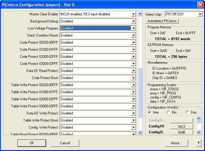

I would start out with a simple program that cannot go wrong. Eg a one second LED flasher. Then you can confirm if your configuration settings are all correct before you start on the bigger programs.
Here is an example of a config that is compatible with a 19.6608MHz crystal.

My guess is that the problem is based on your configuration settings. What settings are you using in the chip -> configure -> Expert settings menu?
Eg
HS+PLL is 4x your crystal speed for a maximum clock speed of 40MHz. Eg 4 x 10MHz crystal.
HS is your crystal speed eg 19.6608MHz crystal
The clock speed in the Project options menu of Flowcode must match this speed to allow delays and components such as the LCD to work correctly.
