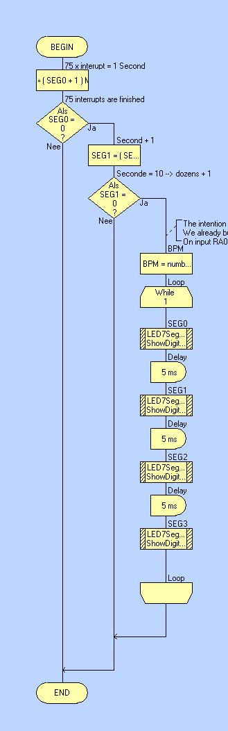

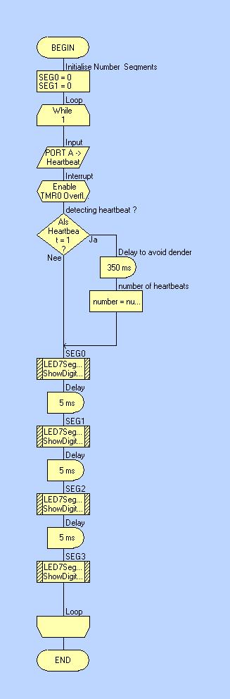

On RAO we count the heartpulses. The value "number" counts up if a heart pulse
is detected. If 10 seconds are passed the value (BPM) calculate the beats per minute.
If we have 6 heart pulses on port RA0 during 10 seconds the BPM = 36 beats per minute.
Buth we can't get the value (BPM) on the 3 times 7 segmenten display using macro LED7seg4(0).
The macro can't see the difference between honderds, douzens and units. So how can we get the value
for example 120 bpm on the 7 segmenten display ? And how can we send data from our microcontroller using max232
to the com-poort of our PC? For our program (see attachment).
Greetz, Dieter

Re: Schoolproject
Hello
Firstly you will probably need to move the 7segment outputs and the while 1 loop from your interrupt Update_Values macro.
In your interrupt you should check if the Heartbeat variable is set and if it is then increment a count value.
To seperate the count value into your individual 7 seg variables you would do something like this.
seg0 = count MOD 10
seg1 = count / 10
seg1 = seg1 MOD 10
seg2 = count / 100
seg2 = seg2 MOD 10
etc
