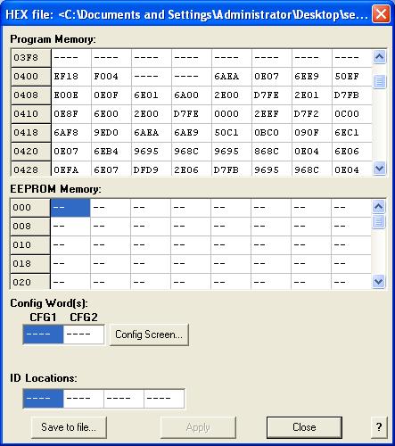

Using our PPP programming software I have opened the hex file and had a look at the contents.
As you can see the code is being placed at 0x400 and not 0x800. Not really sure why this is happening. There is nothing in the rest of the file so this is definatley your program occupying this area of the hex file.
Maybe try setting the offset as 0x1000 and see if that makes the code generate at the correct location.

OK - when I used PPP, it seemed to start the code at 0800 and not 0400 as was for you. That is strange!

Sorry the hex address I was seeing was incorrect as I had a 16F device selected in PPP. Selecting an 18F device showed the hex file started at 0x800 as it should be.
For the HiTech compiler I had to force it to output the hex file as a "Intel HEX with upper address initialization of zero". Is there anything similar available for the CCS compiler?
