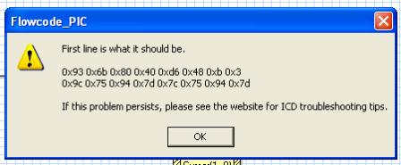

Before few days i received the EB006-00-7 for replacement of FlowKit. Thanks a lot for the accommodation and the gifts included, you are very kind. I tried a simple flowcode project, 8 push button switches to light momentarilly 8 corresponding LEDs and the LCD board to indicate each time e.g. "Switch On : 1" , "LED On : 1" and so on. The programmer section of EB006 it works just fine from the begining, without troubles either in WinXP OS, or in WinXP x64 OS. I tried the project with success in different PICs, like 16F877, 16F877A, 16F887 and 18F4520. The last two i tried as well with their own internal oscillator (removing the corresponding J18-J19 in A6&7 place) with success. Unfortunatelly i had not the same luck with the EB006 in ICD mode. I followed exactly the instructions of ICD manual. I have checked carefully everything. First i make the appropriate settings in the "Chip-->Configuration expert panel" and then i press the "Autodetect PIC micro" button so as the communication is confirmed. After this, i open the "View-->Project Options" menu, where i check again that the PIC settings are correct and then i tick the ICD box. Finally i open the "Chip" menu and i click on the "Compile to Chip". After this the ICD compiling proccess of PIC it starts in the same way like in Programming mode. I can see as well that the on EB006 board LED1 it blinks. All "Return Codes" are "= 0" after the completion of compiling. Now it is time for the ICD operation. When i press the "RUN" arrow, imediatelly it pop-ups an error window "ICD has failed to communicate with the target" and "Make sure the target is powered correctly, then reset it and try again". I follow the instruction, and then i try again the ICD. The same error window pop-ups again, and then i make click on the "YES" button for "Do you want more information?". Then a second window pop-ups with the information. I attach a picture of this window. Because the problem it really persists (as it says the message) i came accross the website and forums enough times without find any topic to help me. Thus, i decided to open a new topic to ask your help.

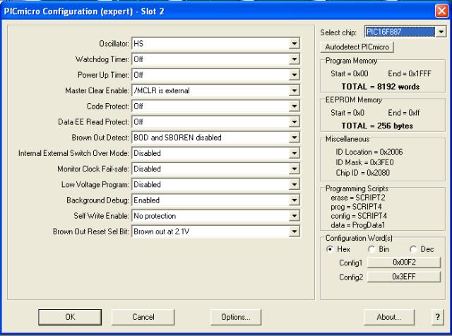

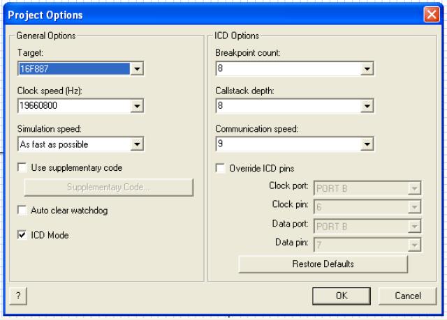

I attach as well two pictures of the settings that i did in a PIC16F887.

Ok, here are 2 things to try:
In the config screen, disable the "background debug" feature.
If this does not work, try increasing the "communications speed" in the project options screen to 20.

Thanks Steve!
With the first modification that you propose, i.e. to disable the "background debug" feature in Configuration window, the ICD function of EB006 is working. Now i am just fine and happy (at least with my Flowcode v4-EB006 v7 multiprogrammer
The increase of communications speed, does not offer nothing. The default value it is just fine. I will try and other modifications in Configuration screen, to find out what else can make the ICD not working.

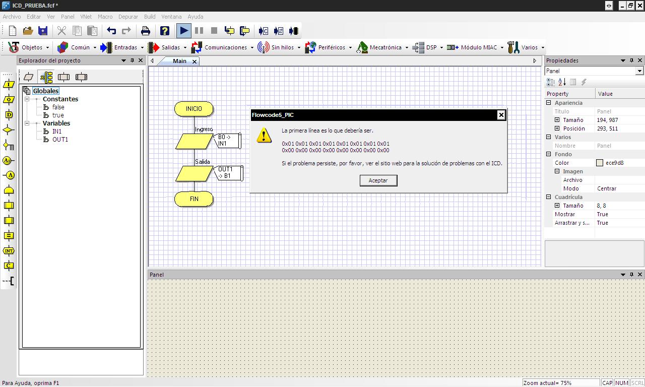

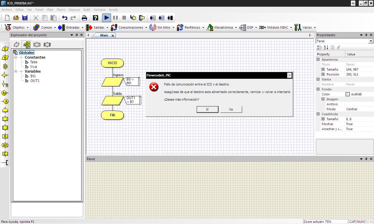

These are the screenshots and the project. I searched the error but can not find anything.

Hi tello,
Your flowchart is set up ok: So it could be an issue with your hardware.
For example make sure J12,J13 & J14 are on USB side and not ICD2
Sw2 should be on Xtal and J18 & J19 on OSC and not A6 & A7.
I would assume you have only got one chip in its socket otherwise there would be an error when you first sent program to your target device.
The only thing I can think of is make a 1 second flasher within a continuous loop with ICD disabled.
If that works then enable ICD and resend to your target device. single step to see if ICD works, then take it from there.

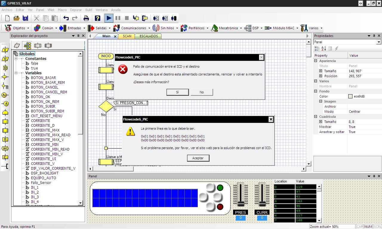

When I connect the EB006 board for the first time by the simple program with LED flash, the ICD is working properly.
When a program more complicated by the ICD does not communicate with the EB006 error off picture.
I do not know how to continue.
This is the program you want to debug.
Thanks for your help, greetings
