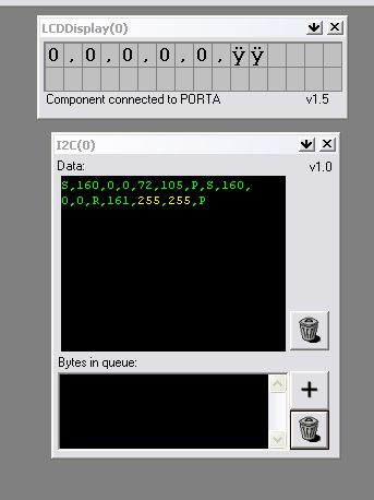

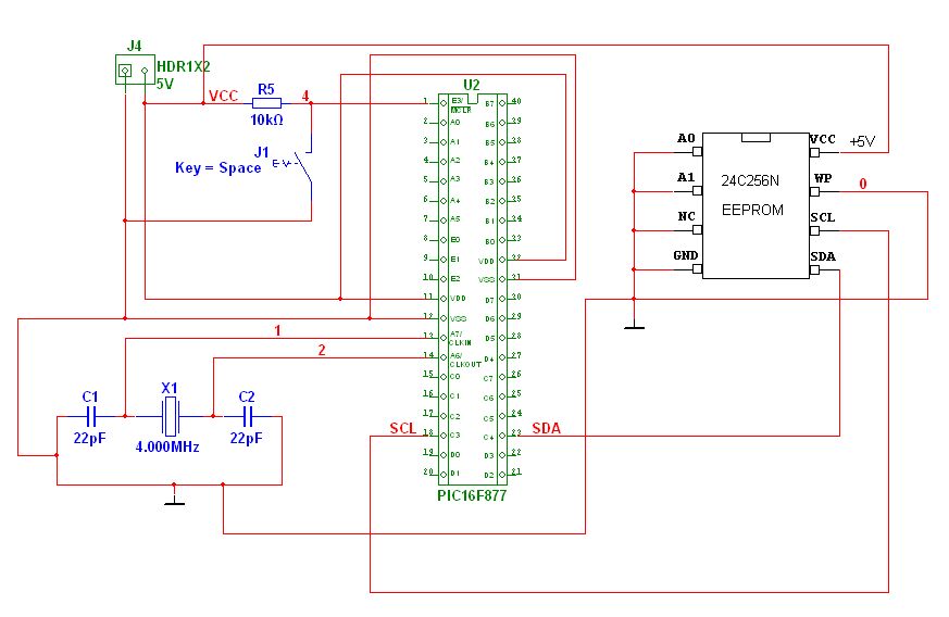

Thank you for responding so quickly. Here are pictures of mounting a PIC and EEPROM on the program Flowcode V3 with I2C.
Y there mistakes?

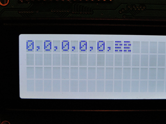

On my LCD it displays "0,0,0,0,0, **"
Note: * = bizare characters :cry:
thank you
parameters and display

diagram EEPROM TO PIC16F877

Yes! I misspoke when I did the diagram to show you my setup. Which were correct, WP to 0V (GND).
Problem: why my data instead of becoming 255.255 72.103 72pour which H i and 103 for either "Hi"? Flowcode in my LCD and two odd characters (see attached images)
my lcd
my lcd
My LCD.jpg (84.54 KiB) Viewed 29639 times

In simulation you must giv the ee-prom value into the queue.
(91.56 KiB) Downloaded 6872 times

Lines SCL and SDA need pull up (4.7k), (they are not drawn on your schematic).
For debugging : Instead of using "Print Ascii" macro you can use "Print number"and see the received values.
Post your file, it will be easier for us to help you.
Daniel

For Dan81 : I added the two resistors. It's just like here? see attachment PIC_EEPROM.jpg
et je joins le fichier I2C_EEPROM_example.fcf

DIAGRAM PIC_EEPROM
DIAGRAM PIC_EEPROM

If jou simulate write to the ee-prom , it do nothing real,only it show data in the " data window ".
The code read in the " queue window " ...if there are not data (you must input it ;click + ...) jou have a mitch match ...
(64.32 KiB) Downloaded 6855 times

yes,thee 2 windows simulate the ee-prom (correctly the data`s on the i2c bus)
For test your real hardware yu must connect at least led`s or better a lcd display.
Regards Wolfgang

After changing the port (port A to port B) Port B default because Flowcode outputs are real!
And after loading the SLC and SDA pins with resistors of 4.7 k everything works!
