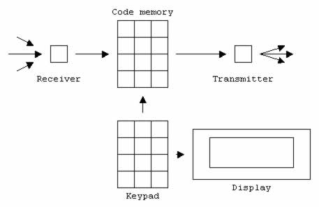

Introduction
This article describes how the new Infra-Red RC-5 E-block (EB-060) can be used with Flowcode to develop a remote control device with the ability to learn codes from other handsets.
The RC-5 E-block contains the hardware required to transmit and receive RC-5 encoded infrared signals.
In this application the transmit channel is used to transmit individual codes allocated to each of the numeric keys on a keypad. The receive channel can be used to allow individual keys to 'learn' new messages (codes) from existing, compatible, equipment handsets.
Component
The example program attached to this article uses a Flowcode Custom Component C file (also supplied) to control the EB-060 hardware.
The code contains definitions to allow this application to run on a PIC16F877A with a 19.6608MHz crystal.
A fully integrated Flowcode RC-5 component will be available in the near future.

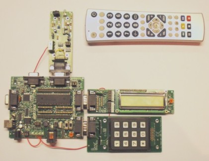

Hardware
The EB-060 should be connected to Port B and configured as follows:
A wire link in the J9 sockets between pins 0 and 6.
The input selector jumper on J6.
The J8 jumper in the OFF position.
The J2 jumper in the 5V position.
The LCD E-Block (if used) should be connected to Port C
The Keypad E-Block should be connected to Port D
Program
The example program accompanying this article uses a keypad and (optional) LCD E-block to represent a traditional remote handset arrangement.
A previous article "RC5 remote control" explained the basics of the RC-5 protocol, which will not be covered in this article.
Default settings
On power-up the keys default to the typical values used for a main television (address = 0; command = key value). Pressing any of the numeric keys will cause the corresponding message to be transmitted.
Transmit mode
The example program handles each key press individually so the toggle bit changes state as each message is transmitted. The program can be modified to allow key presses to auto-repeat (volume control), transmitting repeated messages, with a constant toggle bit value, while a key is being pressed.
Learning mode
The program allows codes from existing, RC-5 compatible handsets to be detected and allocated to individual keys on an EB-014 keypad E-block. Codes for multiple types of equipment (different address values) can be acquired as long as they are all RC-5 compatible. The keys can then be used to control the transmission of each message (the program can be easily modified to use alternative input devices, or internal microcontroller events, to transmit each message).
The program uses the # key to toggle between 'Transmit' and 'Learn' mode. To prevent accidental re-programming, when the # key is used to enter programming mode, it must be followed by the * key. The # key can be used at any time to return to transmit mode.
When in 'Learn' mode, press the key to be re-programmed. Confirmation of the selected key will appear on the LCD (if it is being use).
Point a handset at the receiver on the RC-5 E-block and press the handset button that you want the system to learn. If the message is detected correctly, the values are assigned to the selected key and the system returns to transmit mode.

Re LCD: It has to be connected to port A otherwise require patching not all default pins connections are available on port C
Program now runs, but in learn mode when press a key on the keypad e.g 1 then press remote, nothing happens. LCD keeps displaying Learn 1
I am using EB012 (as not got EB060) with no jumpers in A, B, C, 1 OR 2. got a wire connected from J6 RXIT to bit 6 (tried in bits 2 and 6 as well).
Any ideas please?
