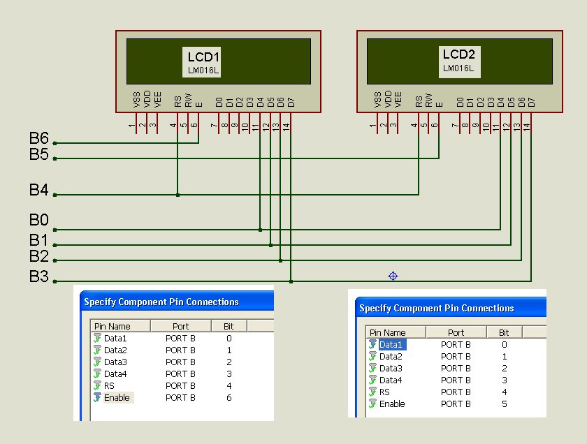

i have 2x16 LCD laying around i might give that a shot as well, do any body got a circuit diagram for it.

Post by Dan81 »
hello singhdeol
you can do something like this
Daniel
PS think to connect VCC VDD GND and R/W
