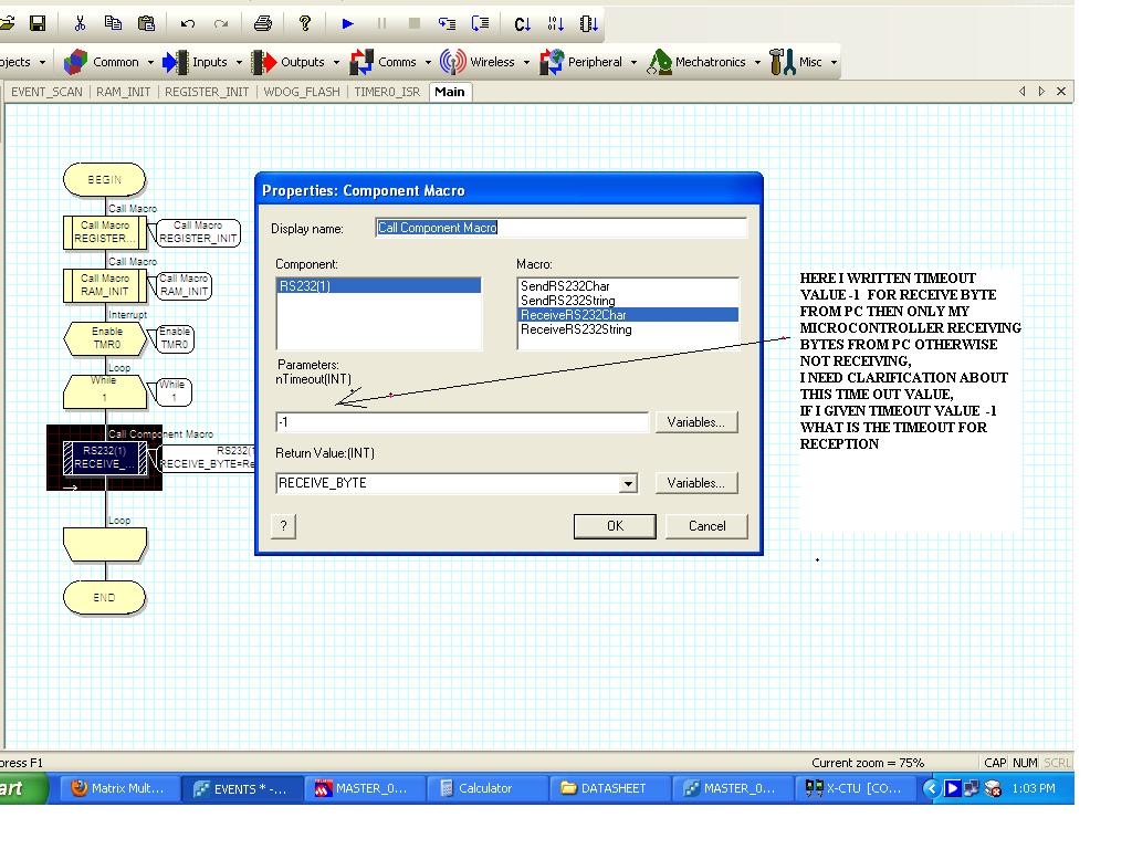

I am using pic 18f8722 microcontroller in our project.
Microcontroller transmit and receive 10 bytes of data from and to host(computer),
Using flowcode v4 i written code for receive and transmit 10 bytes of data to and from HOST(computer).
Using RS232 component receive and transmit the data to and from HOST,
I have following query about RS232 component macro
1)For transmission its working fine but for Reception microcontroller does not receiving data from Host,
2)If i written Timeout value -1 in RS232 component macro microcontroller receiving fine after some time it will stop transmission and reception.
for your kind reference i have attached TIMEOUT.JPEG FILE,
Please go through give me the suggestion for this one.

A timeout of -1 or 255 as it is represented in a unsigned variable forces the receive macro to wait forever for incoming data. What happens if you set the timeout to say 100 or 10? Its good to have a decision directly after the RS232 read to check if the received byte is less then 255 and therefore valid data.
