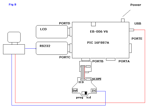

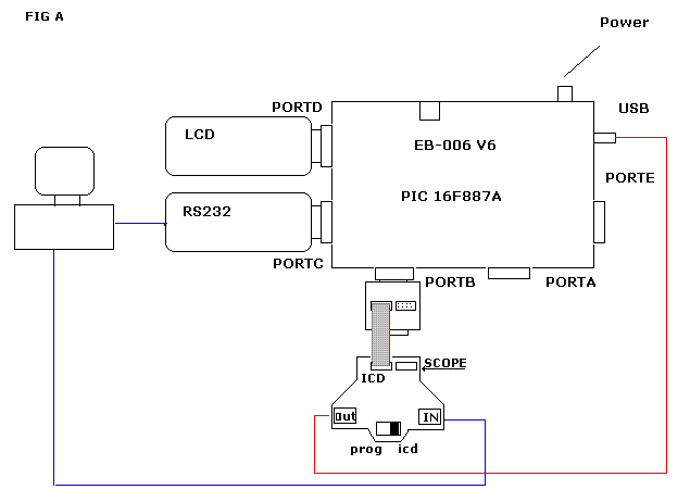

In “Project options” the flag “ICD-Mode” is on, it doesn’t matter if I use the default setting or not, the result is every time the same. That’s also for the other options.
The PortB is only used for the HP299-Flowkit.
I did connect it as in picture FIG A. or FIG B.
I did try both, nothing works

Hello Taurus,
I would wire up as in Fig A and then assuming the ICD / PROG switch is in the ICD position then the debugging should work ok.

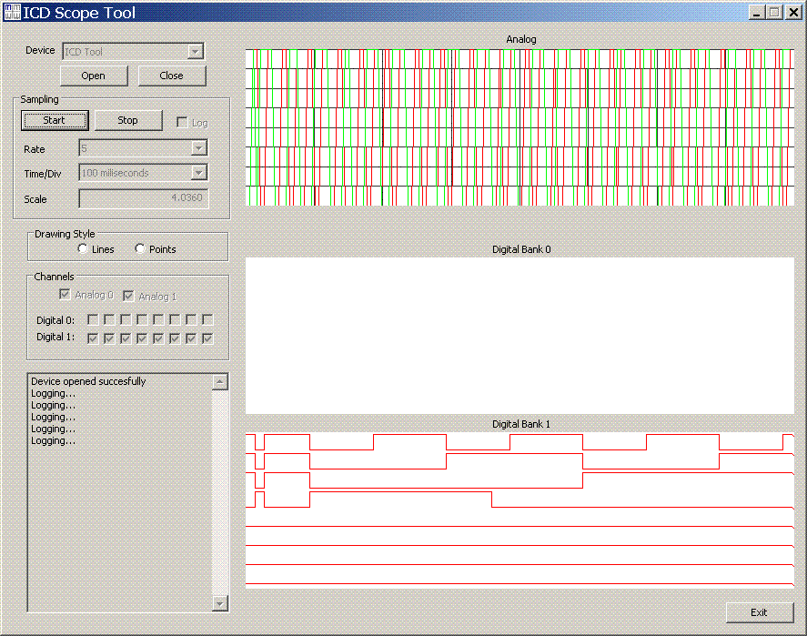

Another way that I tested the HP299 with the ICDScope with the little program HP299_ICDScope
a) Disconnect the Subd 9 connector from portb
b) Send the program to the PIC, yellow led is blinking, PROG.
c) Start the program from the PIC
d) Connect the subd 9 to the ICD and portb
e) The flowkit reads only the b0 to b3, but not b4 to b7 (see Sample_ICDscope)
f) Disconnect the Subd 9 connector from portb
g) Connect the subd 9 to the Scope and portb
h) The flowkit reads now the b0 to b7.
It looks like that there is something wrong with the ICD port pins on the HP299 Flowkit.
a) What could it be.
b) Is it possible to load new software into the HP299 Flowkit to solve this problem?
c) Is there another way to test if the HP299 Flowkit works?
d) Is it possible that it has something to do with the PPP3 driver?

Could you also do the ICDScope test and see if you have the same result.
As you can see only the bits 0 to 3 change, I would expect it would be 8 bits or at least 6.
Is there something wrong is with the input/ouput from flowkit, software or communication.

Re Scope function:
The only pin the scope does not monitor is the LSB so this could be portB0, D0 etc. The only way that I could monitor all 8 bits is to use one pin from the ICD Pins side and have ribbon connector plugged in scope side. I did also notice If Connector was plugged in ICD side then not all channels are monitoring like they should be. But it was mentioned that scope function was not finished yet, but it was released to the public early, so not expecting it to fully work yet. Looking at Steve's picture of scope software monitoring, Top waveform is the same as mine, which was not correct. So maybe that's an inherent bug?
Re ICD: I had no problems in running Eb006 (although its V7 I used Flowkit, with USB disconnected from programming board)

Re: HP299-Flowkit problem with EB006-00-6
Hello Ben, Medelec.
After installing XP again Flowkit did work again.
Option B is the best one, because you don’t have to disconnect the USB cable every time.
