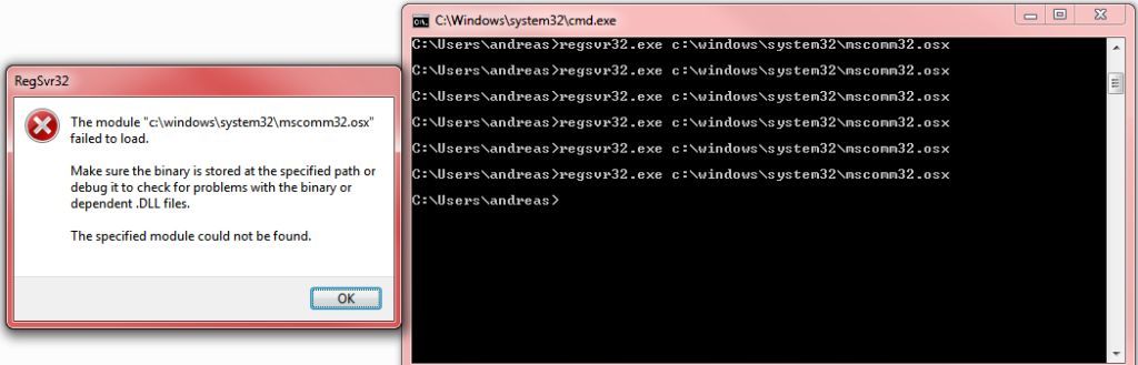

I am trying the routine and I get error, can you help?
The file exists in system32.
Thank you in advance,

This is the same problem I have been getting.
I've not had chance to really investigate further, but it could be down to my system running 64 bit windows(Windows 7SP1)
Does the same with or without SP1installed. Think the file is only compatible with 32bit OS.

I never had that error :/
As JohnCrow mentioned it, it could be that the file is only 32bit OS compatible.
I "installed" that file on a Windows XP 32 bit OS.
EDIT:
You wrote "regsvr32.exe c:\windows\system32\mscomm32.osx" instead of "regsvr32.exe c:\windows\system32\mscomm32.ocx" !
Hope this solves the problem ;)

I have corrected that one and the error stiil's the same.
Must be the 64bit Win7, I got the same OS!!!!

You might need to launch the cmd window with elevated privileges (i.e. find cmd.exe, right-click and select "run as admin...").

That did not help, stil the same error!

Okay so I got it to work on my brother's 64-bit Windows 7 PC.
Here's how I did it:
- Copy mscomm32.ocx into C:\Windows\SysWOW64\ (instead of system32)
- Execute the next command : "regsvr32 C:\Windows\SysWOW64\mscomm32.ocx"
That's it ;).
Dont forget the above command has to be done as administrator

I am trying to drop the MScomm button in the user form and get the following error: ''the subject is not trusted for the specified action''.
Got any clue?

Now the TOOLS>ADITIONAL CONTROLS is all greyed out and cannot select it!
Spanish_dude

Re: PC to PIC communication: Part 1
Post by Spanish_dude »
Hi achillis1,
After a quick search on google I found this forum page : http://www.vbforums.com/showthread.php?t=622730
This should resolve your problem.
PS: Be careful not to change the wrong registry as this may prevent Windows to start up or to work properly.
achillis1

Post by achillis1 »
Thanks for your help but that didi not solved the problem!!!!
Thank you
