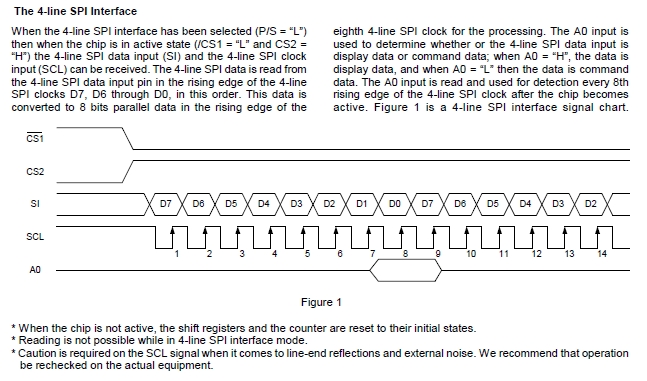

I finally received my serial displays. I decided to bit bang the data, as it is only data out (you can’t read from the display in serial mode).
I can’t seem to get the display to initialise. The SPI data is read from the serial data pin in the rising edge of the serial clock. D7 through D0 (MSB first)
I have been using a Custom C code component in Flowcode 4. Here is the bit bang section, can you see any problems?

Data sheet info is as follows:
- SS7565.jpg (142.54 KiB) Viewed 7330 times

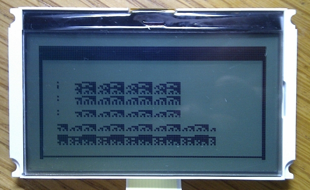

The problem I have is that it wont display any characters correctly and seems to be double spaced.
I think that it has something to do with Reading the display, or the page function. When I draw a text box it seems to not recognise the vertical line numbers, It jumps up 8 pixels at a time.
Eg doing an outline the top is either not there or about 8 pixels thick. photo below
In the photo, Inside the box, the text is “Hello” (centre) and I drew two lines one across the bottom and one vertically in front of the text.
Note: I disabled the Read display function, and the horizontal line draws correctly, but vertical line and text are not displayed.
