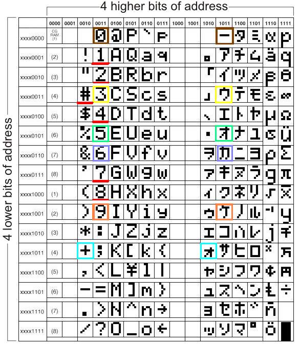

If you look at the attached file all the character under lighned in red comes thru like they should but you will see that the numbers with different colors are replaced by the signs with the same color.
If I use HyperTerminal with 9600,8,N,1 to send the characters it work fine but when I set HyperTerminal to send with 9600,7,odd,1 I get the same characters as from the Instrotech instrument.

Right ok it looks like this code should work for you to remove the parity bit.
Component Macro: data = ReceiveRS232Char
Calculation: data = data & 0x7F
This code clears the most significant bit that is causing your incoming characters to appear as 0b1011xxxx instead of 0b0011xxxx.
