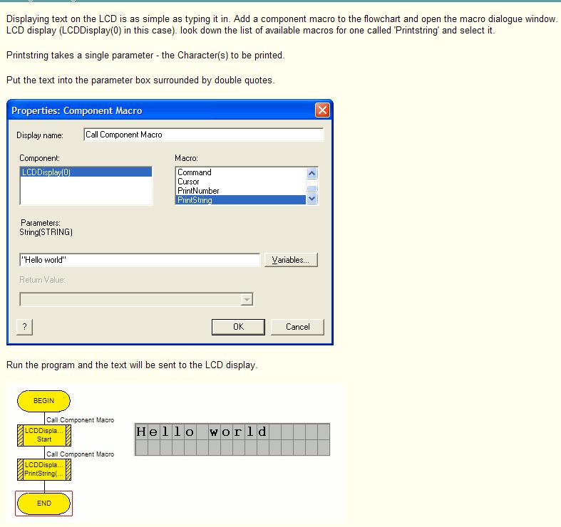

i would like to know the flow chart of that test
thank you
and also i want to know why the LCD doesn't display anything when i do the LCD test.
And has no error came out
Is it the license problem?
thank you
(62.82 KiB) Downloaded 1365 times
Re: how to do temperature test?
Please could you attach your Flowcode program to the forums and I will have a look for you. Are you testing on hardware or using the Flowcode simulation?
