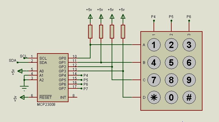

Hello
I'm still using "Customize Component Code" !
I like I2C protocol (sorry for other comms users), there are only 2 wires for this bus (and pull up) .
You can choose any keypad (allowed by Matrix, from 1x1 to 4x4, see Extended Properties).
The expander can be a MCP23008 or a PCF8574.
The only rule is to respect the schematic below :
Columns : from P4 to (P7 or less) ,
Rows : from P0 to (P3 or less).
Pull UP for rows are not needed , MCP and PCF have internal ones, Matrix Eblocks (EB-014) has pull DOWN resistor.
The simulation with Proteus is OK, as soon as the real test is done I'll post the code. I'm waiting for the keypad.
Daniel

I just want to add that you need to enable the pull up resistors first by sending 0xFF to the GPPU control register.

Hello
I have created a new component macro "Init" where all the configuration of the expanser is done.
This macro must be put AFTER the "Init" of the I2C component. (the same thing like LCD I2C)
Daniel

How to use I2C Keypad.
INTRODUCTION
The pinout of MCP 23008 is more interesting than PCF8574 one
The "MCP version" is hard tested on a EB016 (prototype board). "PCF version" is only simulated on Proteus 7.8.
Note : I2C Keypad address (0x21) (different from I2C LCD :0x20).
TECHNICAL
For hardware the only rule is to respect the schematic given above.
The Pull Up resistors are not needed, they are "native" on the PCF, on MCP they are enabled during initialisation.
For the Software,
Choose your keypad as usual (1x1 to 4x4), the macros are identical (and simulable).
You must also add :
- a I2C component and its init macro.
- The Keypad init (a new macro called KP_init) AFTER the I2C init macro.
Note : I2C is only "Hardware" (by default in the properties).
Note2 : It is not necessary to provide a port for the keypad connection.
Remark :
- I have done the same thing for the Switch bank and Led array.
INTRODUCTION
TECHNICAL
For the Software,
You must also add :
Remark :
