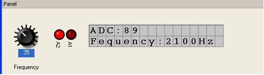

I have developed a simple Square wave frequency generator for Flowcode V4, which covers 500Hz to 5KHz in 100Hz steps with Frequency displayed on LCD.
Also displayed is byte value of POT connected to RA0.
I have used a 16F88 configured for 8MHz internal oscillator. This cuts down component count.
You can use output's RA1 to ground which produces 5V Peak, or use RA1 and RA2 and this produces 10V Peak since RA1 o/p is complement to RA2.
I have tested O/P with a frequency counter and frequency on my setup is very close to displayed frequency.
If you have a piezo transducer with unknown resonant frequency, just connect between RA1 and RA2.
Adjust POT to vary frequency through whole range. When Volume is at its loudest, then you have found the correct working frequency.
If you find transducer too loud then connect between RA1 and GND.
Freq Gen1.JPG (10.36 KiB) Viewed 52309 times

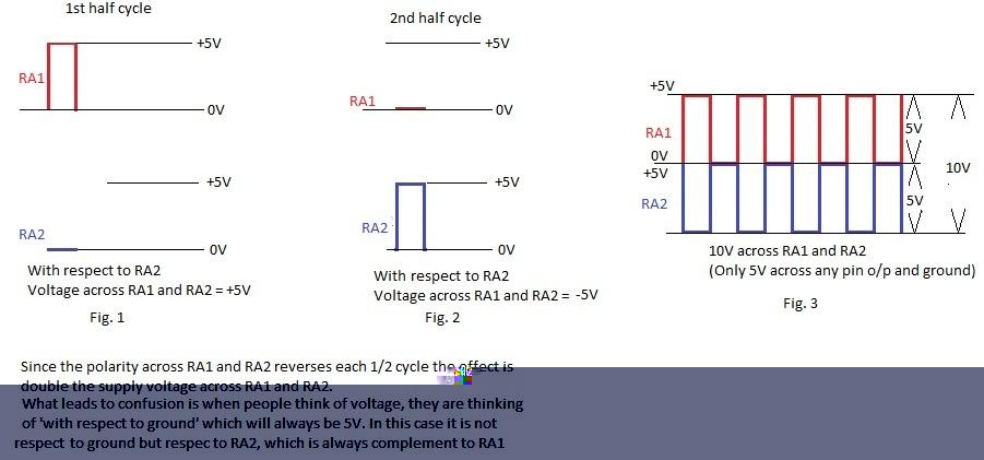

For people who are interested, I was asked in a pm how the 10V is generated:
To generate 10V pk to pk with a 5V supply.
here is a diagram to help illustrate principle
On first 1/2 cycle: Simultaneously the software drives RA1 to 5V and RA2 to 0V
on the 2nd 1/2 cycle: Simultaneously the software drives RA1 to 0V and RA2 to 5V, So RA1 and RA2 are complementary.
So if you connect one end of piezo transducer to RA1 and the other end to RA2, the transducers sees 10V pk to pk instead of 5V.
10V pk to pk.jpg (46.45 KiB) Viewed 52260 times
Hope this helps.

I just connected piezo element directly between RA1 and RA2 and it was very loud.
Had to cover ear if got to near.
This was due to hitting resonant frequency of piezo element.
Did not use any resistors or transistors.
Just a 5V supply.
That gave 10V pk to pk
With Enamul's circuit, it will be even louder at 24V pk to pk
