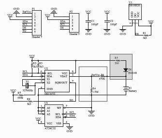

A similar circuit to the elektor one can be found in the data sheet.
The DS1307RTC operates using the I2C protocol.
I2C Bus Connection.
DS 1307 Pin 5 = SDA To PIC PORT C bit 4
DS 1307 Pin 6 = SCL T0 PIC PORT C bit 3
Note both these lines need a pull up resistor connected to 5V

The prototype RTC has now been transfered to a EB-017 Patch Board
The slide switch near the Lithium battery is to switch the battery out of circuit when not needed. This conects Pin 3 on the DS1307 to ground.
The RTC will still function in this mode, as long as the circuit is powered, but if the power is removed, the RTC will loose it settings.
A couple of capacitors are placed between the 5V and ground buses.
Pin 5 = SDA
Pin 6 = SCL
Pin 7 = SQW
These can be patched to the relevant pins on the processor using jumbers
These lines have 10k-ohm pullup resistors to the 5V line.
The 3 push switches are available if a set of switches are needed for the application the RTC is used for.
Again these can be patched using jumpers.

Just built a new version of the hardware.
The circuit is exactly the same as the one above, except its a lot smaller and has wire connections rather than the D-Connector.
Care must be taken with the routing of the data/clock wiring anf not to have the wires too long.
Also i have not fitted a switch to isolate the battery backup. The current draw is in uA so a lithium button cell is still going to last for a long time.
DS1307 RTC V2.JPG (78.1 KiB) Viewed 279997 times
The LHS blue terminals are 5V & Gnd
The RHS blue terminals are SCL & SDA (I2C bus)
