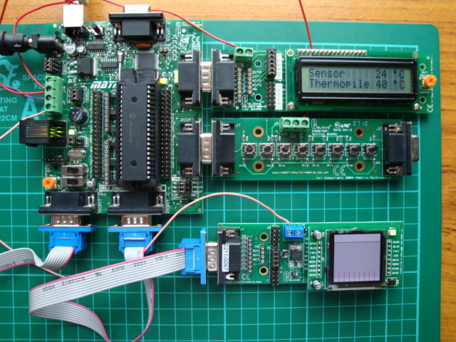

EB006 Multi- Programmer (Standard crystal and 16F877A Microcontroller
EB005 LCD Display PORT A
EB007 Switch Board PORT B
EB058 gLCD Display PORT C
EB016 Proto-Board with TPA81 PORT D
Connecting Wires

The LCD display cycles between the 2 sets of readings.
The average of the 8 thermopiles is shown along with the sensor internal temperature.
The maximum and minimum values of the average thermopile readings is shown.
The 8 thermopile values are shown graphically using the gLCD display.
These range from 0°C to 100°C

Complete System
Complete System
Complete System v2.JPG (139.15 KiB) Viewed 4895 times
TPA81 Sensor On Development Board
