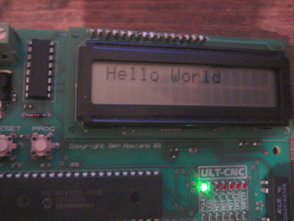

Re: Run out of outputs
Hi Steve,
Ok I've tested the component code file now and it appears to be working well on my hardware.
2011-09-09 00.03.04.jpg (33.47 KiB) Viewed 25760 times
I've also had a look at the Farnell part you mentioned and it should be 100% compatible with the component C file.
Which microcontroller pins are you using. Pin RA4 on some devices is not capable of outputting a logic 1 without the aid of a external pull up resistor.

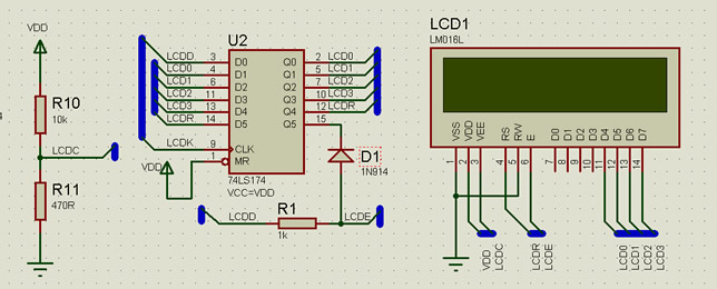

Here is a copy of the LCD portion of the schematic for my board.
The pins going to the microcontroller are the traces marked LCDK (clock) and LCDD (data). Note the supply pins (8 and 16) for the 74LS174 device are not shown but are connected.
R10 and R11 should ideally be replaced with a preset potentiometer so you can set the contrast for the specific display on the board.
There's also some 100nF ceramic caps and a 10uF elco cap across the power rails VDD and GND that are not shown on the schematic. These are not strictly nessisary but may help if you have a noisy PSU etc.
If your still struggling to get it to work then have you performed a 1 second flasher test to confirm your Flowcode clock speed and config settings are correct for the hardware? If you need more info on this let me know.

attached is my circuit diagram which looks like your's

Sort of sussed it out now the voltage level was dropping too low when the output of flip flop 2 went high then nothing worked correctley.
just placed two nand gates in the data and clock lines to act as a buffer now i can see all the flip flops working on the led board.
ordered some 74HC05's and going to try again . . . Looking good so far :D will let you know when i have another go
Hi Steve,
Your schematic looks correct apart from the labels for Clock and Data and the wrong way around.
