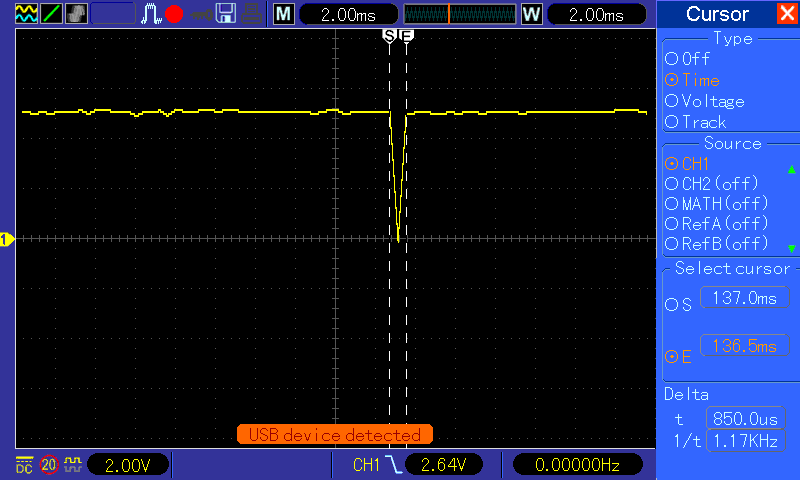

When I press reset the only thing I see on my scope is SDA that goes done for 850us and not after each reset.
I checked the log, in the C compile no errors just warnings in assembler part (see copy)

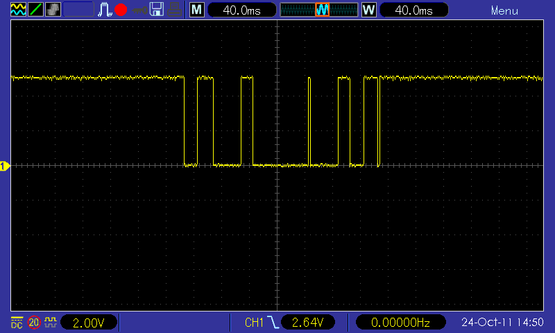

And here is the same program but with a 18F4455 (crazy)

Problem solved !
I had also a DS1307 in circuit and it seems to be a bad one ...
But I can't explain why it worked with the 18f4455 :?:
