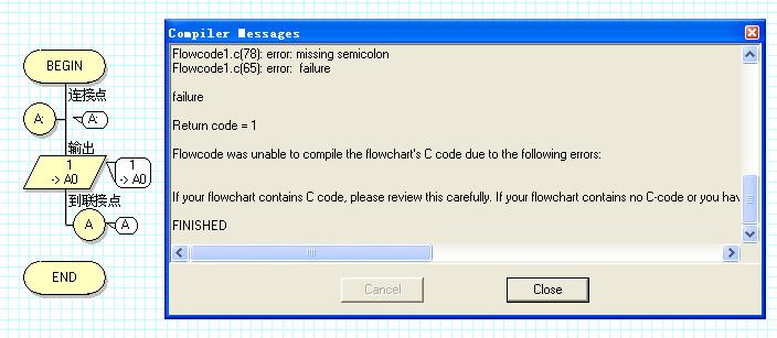

When V4 software choose language as "Chinese simplified", if the application in appeared "connection" figure operator program, the compiler will not pass, must fail!!!!! This is a very deadly bug in Chinese schools for the students to use.
Problem figure
Problem figure

hi nnnnff,
Have you tried on a PC that't set to Chinese?
This is only a complete guess so I could be wrong and maybe a bug? :P
I believe what's happening is:
If trying an a PC which has not got Chinese fonts but only displaying English, then when compiling to hex the word Main (but in Chinese) is not recognised since fonts used can't create the word main in Chinese.
If you have access to a pc that's set to Chinese language then would you mind testing my theory please?

I'm a Chinese university teachers, using the PC is the Chinese system, so find the deadly bug. Please help me. Thank you!

I'm not sure if it's flowcode bug or something else. I'm not use chinese version window.
Base on C file , suspect there something wrong within the main() function .

I tried some alternative ( make a new makro ) and it no problem ( using english window version ) and compiled perfectly.

Choose English, compiled without problems.
Just in the choice of Chinese have compiled.

This is a known problem with the Chinese version of Flowcode v4. Basically, using a "connection point" in the "Main" flowchart will cause this problem.
This will be fixed in Flowcode V5. For a workaround, you can use the attached file. Unzip the attachment and copy it into your Flowcode directory. You may want to make a copy of the original FlowZHCN.dll file as a backup.
