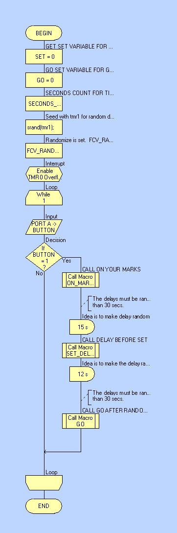

I've started the flow chart, I need help with the c-code. How do I use the random value to influence the delays?

Hi Ziggy.
In your flowchart, create a variable and call it, say, 'rnd_seconds' - if you are only worried about an accuracy to the nearest second you can create this as a byte or int, it doesnt matter.
Now create a calculation icon containing the code:
  rnd_seconds = random() % delay_time
Where delay_time is the time you would like to wait for as a maximum. You can then use rnd_seconds in the delay field and this will wait between 0 and delay_time.
I'm sorry, but I dont have v3, so cant post a solution file but the screenshot below shows a macro you could call that allows you to wait between 'min' and 'max' seconds. You can call this from the various places in your program. Note this macro uses local variables.
I hope this helps.
