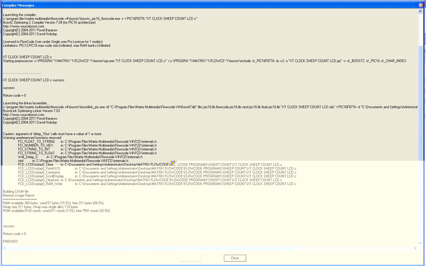

I am getting warnings during programming, so I will attach them.
- COMPILER WARNINGS
- (202.07 KiB) Downloaded 4064 times

Hi Craig,
When you get warnings about ' unreferenced functions removed:'
or Caution: argument of 'delay_10us' calls must have a value of 1 or more
They are nothing to worry about.
For instance :
Just means you did not use the FLOAT_TO_STRING or NUMBER_TO_HEX or STRING_TO_INT or STRING_TO_FLOAT functions, so they have been removed.
I think those warnings are a bit illogical, since we created the flowchart so we know what we did or did not use
But developers of BoostC must have there reasons, and they could be there for an important purpose?
The only thing I can see missing is you have not got a single RA2 output set to 0.
I placed that at the beginning of my flowchart : The purpose of setting RA2 (connected to LCD R/W on QL200 board) to 0V is your R/W which must be connected to ground (0V) in order for your display to work.
As for the delay warning, again nothing to worry about. Should not affect your program at all.
For instance :
Warning unreferenced functions removed:
FCI_FLOAT_TO_STRING in: C:\Program Files (x86)\Matrix Multimedia\Flowcode V4\FCD\internals.h
FCI_NUMBER_TO_HEX in: C:\Program Files (x86)\Matrix Multimedia\Flowcode V4\FCD\internals.h
FCI_STRING_TO_INT in: C:\Program Files (x86)\Matrix Multimedia\Flowcode V4\FCD\internals.h
FCI_STRING_TO_FLOAT in: C:\Program Files (x86)\Matrix Multimedia\Flowcode V4\FCD\internals.h
That is correct since now your pin assignments are now the same as the flowchart I attached.CRAIG CHAMBERLAIN wrote: I was using incorrect pin assignments. All the data pins were wrong.
