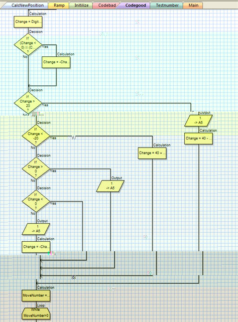

Hi Guys, I have been working on a fun project until I hit an area I just cant seem to figure out? :( The area I am working on is in tab CodeGood were I have four if decisions in a row. What I am trying to do is: Imagine a Train Engine that pulls onto a turntable with the head of the engine we will say is at the index 00. The operator wants to move the engine to any of 1 through 40 positions around the turntable. But he wants to take the shortest way clockwise or counter clockwise to get to his new destination. I have been able to almost get it using four if decisions but always can find one situation that doesn’t work. You could see what my program is doing with the file below. Its best to simulate at 1000 in the panel options simulation speed and put a toggle brakepoint at the change = Digittotal - Index calculation so you can mouse click through this area. Run the program than toggle the initialize switch this is going to index the tuntable at 00. From there you can enter a position 0-39 and push the enter button. The variables I watch are Digittotal the number entered into the keypad to move to, Index the number of the current position, and Change the difference between Digittotal – Index. If anyone could give me a clue as to how I should be doing this I would be very grateful!!

One way to find the quickest distance to travel would be to take the current position and then create a loop to count up from the current position to the desired position. Inside the loop increment a counter and this will end up being the total steps should you increment the position. Repeat the loop but this time decrement the position and increment a second counter. AT the end of the two loops compare the two counters and move in the direction that has the lowest counts. You will probably need a special case for when the counters are equal.
eg.
Decision: Count1 >= Count2
Move Clockwise Count 2 positions
Else
Move Anticlockwise Count 1 positions

Hi Ben, I played around with my program for a few hours today but am not getting it? I always end up with one of the loops going off in a direction that won't end the loop. I have the decision part down ok, It just the loops that are giving me trouble. If I have the loop counting up until current position = desired position (Count1) the second loop just goes on forever (Count2)? Thanks for the help!

Here is my thoughts.
You could have a calculation:
Required_Steps = 40-(Required_Position - Current_Position)
Then have a decision branch:
If: Required_Steps>40
Then: Required_Steps = Required_Steps - 40
Finally have the final decision branch
If: Required_Steps >20 Then: Required_Steps = 40 - Required_Steps: move counter clockwise // moves Required_Steps counter clockwise
Else move Required_Steps clockwise// So count = Required_Steps
Hope this makes sense as not long woke up and I'm half a sleep :lol:
So I can't guarantee it will work of course.
If I have not made much sense & I get a chance, then I will integrate this routine within your Flowchart to see if it works.

I have integrated calculations into your flowchart.
Can you let me know if works OK or not.
One comment I would make. You have got If change < 0
and
If Change < -20
Since Change is a byte and not a signed integer, it can never be less than 0 or greater than 255.

I was so close to your solution so many times it makes me crazy!! What you came up with is a thing of beauty in its simplest form. I want to print my flow chart out and show it to everybody and let them know my friend Martin came up with this, isn’t it genius! I can’t thank you enough!! I thank you too Ben!! :D
