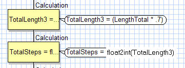

Hi Martin, Thanks! Is Float_Var listed as a Float point (Type)? I tried it and it simulates and compiles however does not seem to return an int?
[img]
[/img]
Thanks for the help Buddy have a great day!
Werner
Werner
STUDENT OF: Martin - Professor of Flowcode, John, Jan, Fotios and Nicolas "Spanish Dude"
Posts: 9521
Has thanked: 2585 times
Been thanked: 3815 times
Re: Is there an easy way to round a floting point number up/
Hi Werner,
I have posted an example flowchart.
The reason why yours is not working is probably because you have not used fmul() function to multiply the float by 0.7.
If you just use float_Var * 0.7 then float result in simulator will be 9.936800, but it will be 0 in real life.
float 2 int.fcf
(5 KiB) Downloaded 267 times

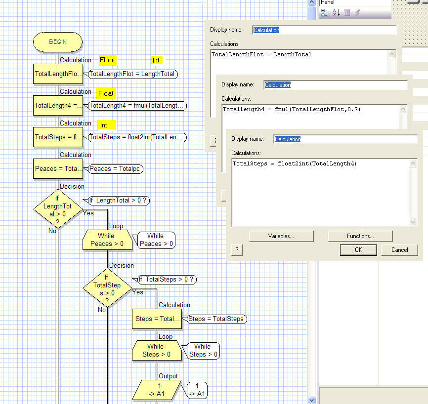

Hi Martin, Thanks! I think I see where my problem is? LengthTotal is an Int, made up from a adding a few variables together. It does not look like I can do what I want and that is to take my float variable TotalLengthFlot = LengthTotal a none float?
[img]
(202.99 KiB) Downloaded 1282 times
[/img]
Thanks Buddy!
Werner
Werner
Posts: 9521
Would you like to post your flowchart (pm if u want to keep it private) then I will see if I can get it working the way you want it to.
Spanish_dude
Posts: 594
Joined: Thu Sep 17, 2009 7:52 am
Location: Belgium
Has thanked: 63 times
Been thanked: 102 times
Post by Spanish_dude »
There's an int2float function. Try that with your first calculation box (even thought I don't think it will change anything).
What is the value of TotalLength4 ? Is it a point number ?
I'd double check the variable types, just in case you oversaw a wrong type.
Werner
Posts: 95
Joined: Sat Jun 11, 2011 4:12 am
Has thanked: 87 times
Been thanked: 31 times
Post by Werner »
Thanks Spanish, Yep that did it! You and Martin had both found it. You Guys are great!! :D
Have a great day!
