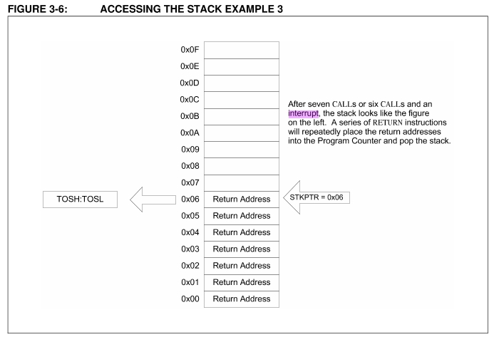

More interrupts can be handled, depending on the number of maco calls and interrupts. They may not overflow the stack.
Good programming prevents always that same interrupt called without ending the first (thesame) interrupt.
If you try, the result will be hard to check for faults and a stack overflow is often the result.

I believe if you place a delay, or LCD routine (or any other component that has delays )or call to another macro within the delay, then the interrupt is re-enabled as soon as the interrupt macro is briefly left to service delay, or LCD routine of call to another macro. Not only will this add to the stack, it will cause corruption issues.
The interrupt routing must never be left except when reaches bottom of the interrupt.
