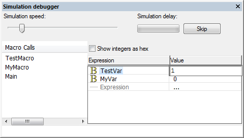

Changing variables during Simulation
When simulating variable values can be changed from the Simulation Debugger window by clicking on the 'Value' box next to the variable name and then simply typing in a value.
If the ICD Mode is enabled in your Project Options then stepping into or over in the simulation will cause the ICD hardware to react accordingly. Changing variable values during the simulation will also work seamlessly with the ICD operation.
