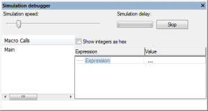

[[File:Gen_Simulation_Debugger.png|thumb|right|Simulation Debugger]]
====9) [[Simulation Debugger]]====
This window appears when simulating a flowchart, it shows the current macro being simulated as well as the values of any variables selected, the values of the variables are updated for every command simulated but does not update when running the simulation 'As fast as possible'.

Simulation Debugger
9) Simulation Debugger
When simulating a flowchart, the values of any variables used can be seen in this view. The values of the variables are updated for every command simulated but the view is not updated when the simulation is running at full speed.
