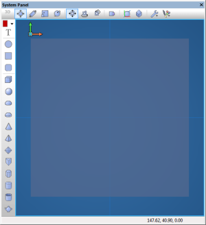

System Panel
5) System Panel
The System Panel provides a real-world framework on which to load Flowcode components. It then shows how these components perform during simulation of the current program. It can be customised by adding different background layouts, grids, images etc.

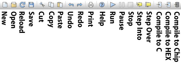

10) Main Toolbar
Use this command to display and hide the Toolbar, which includes buttons for some of the most common commands in Flowcode, such as 'Open' (File > Open), 'Print' (File > Print) as well as Compiling the flowchart to Chip, HEX and C. You can even control simulation by running, pausing and stopping simulation using this toolbar as stepping into and over icons to simulate step by step.
