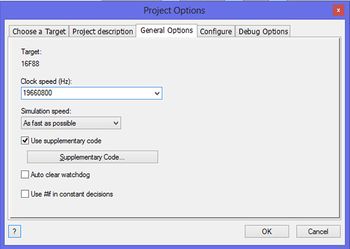

There are two mechanisms for adding your own C code to a Flowcode flowchart:
  • using the 'C Code' icon Btn C Code.gif ;
  • using the 'Use supplementary code' facility within 'Project Options', shown opposite:

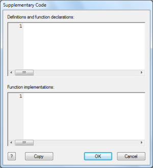

Adding supplementary code
This feature is used when you have blocks of code containing routines, definitions, lookup tables, etc.
Definitions and function declarations:
This is the first section. It allows users to initialise the program, by adding structures such as 'defines', 'includes', and other function declarations. This section must be placed at the beginning of the C file so that the code is 'visible' to all parts of the program.
Function implementations:
This second section allows for the addition of the main function code.
Structured thus, the code is accessible to any Flowcode macro, and vice-versa.
