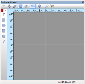

Dashboard Panel
6) Dashboard Panel
The Dashboard Panel provides another framework on which to load Flowcode components. It is usually used for buttons to control components on the System Panel. It can also be customised by adding different background layouts, grids, images etc.
